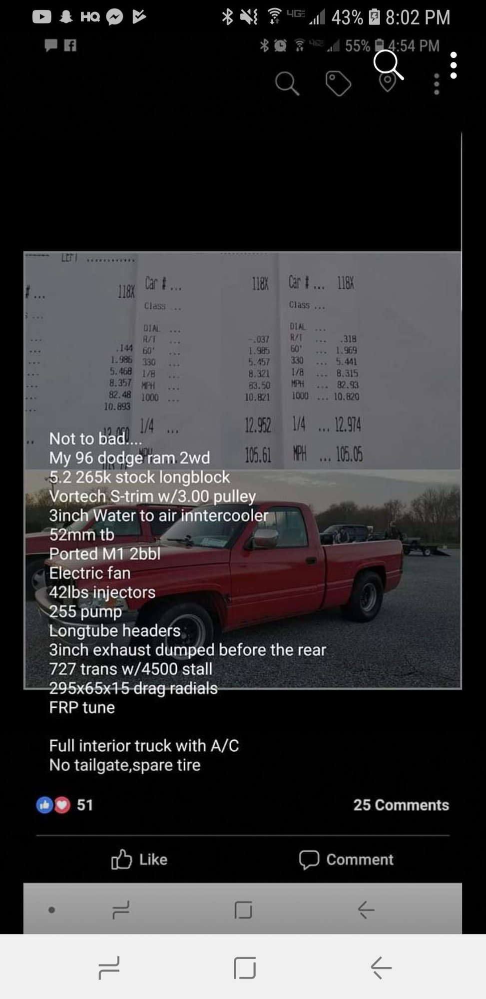

LOL by who? Some "real experienced racer whos been building cars for 40 years"? That's not at all true. I can name 1 truck in particular, regular cab short bed 318, that has 250k on the factory LONG block. Not even just the bottom end, heads too. Runs low 12s on 13psi if i remember correctly.

i misspoke, 265k. Although more recently he's posted 270 as he drives it pretty regularly. Also i was wrong on his boost level, it's 11psi. The 13psi was when they were tuning and dialed it back. Official 1/4 time is 12.76, i was off there as well.
but you get the idea

The blower systems that have been or are available for these are: TorqStorm (available), Vortech (not available), Paxton (not available), ProCharger (available) and KenneBell (not available).
The procharger is the only one that came with any sort of tuning and it's pretty much a superchips canned tune, similar anyways, and not worth much at all. The rest ran boost referenced inline fuel boost pumps to increase fuel pressure to increase how much fuel was actually delivered. That's ok for lower levels but it very quickly becomes dangerous, particularly because it doesn't account for timing.
