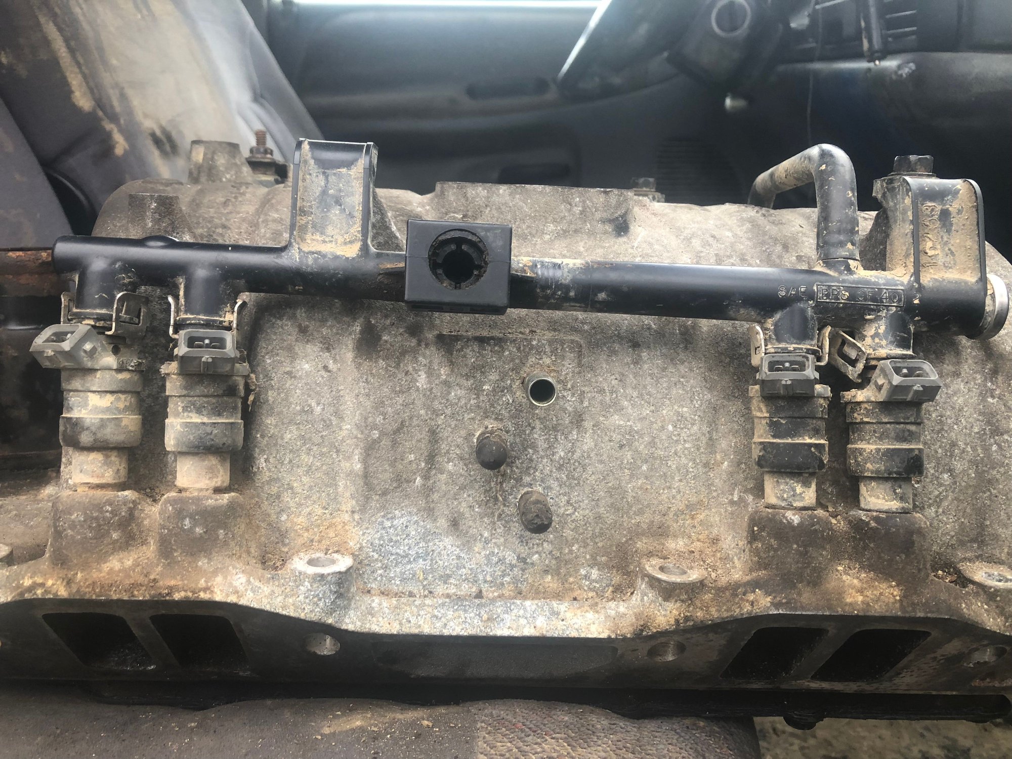

Is this hole towards the back of the intake the EGR you guys told me about? Is this still useable?
Would I have to block that hole off?

Yup, that intake has a provision for an EGR valve. The hole in the back is for a steel tube to thread in that routes over to the exhaust manifold on the early year RAMs ('94-'95 and some really early '96). The manifold you show in the photo has an EGR block off plate on it already where the EGR valve would mount, so you are golden.

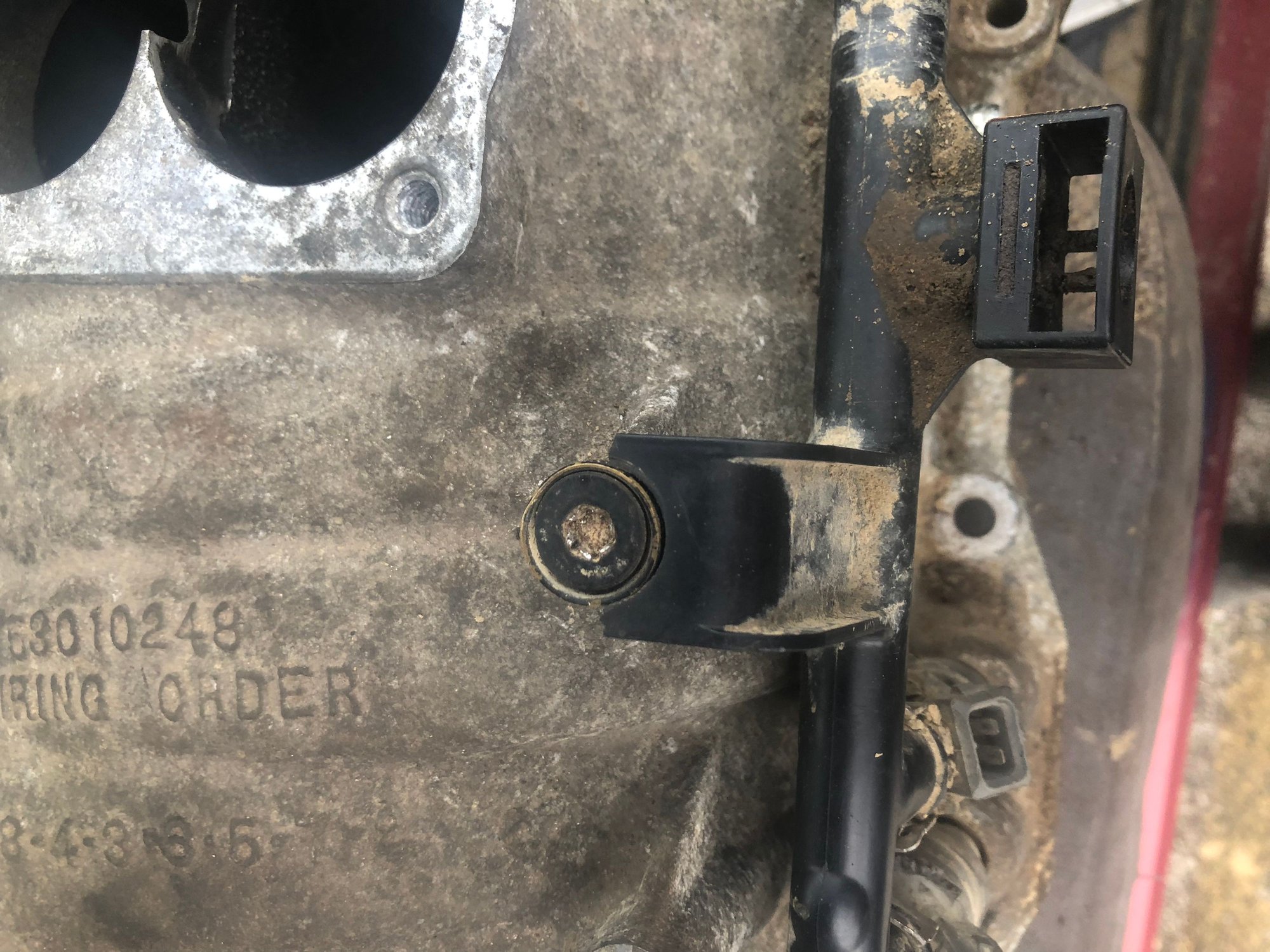

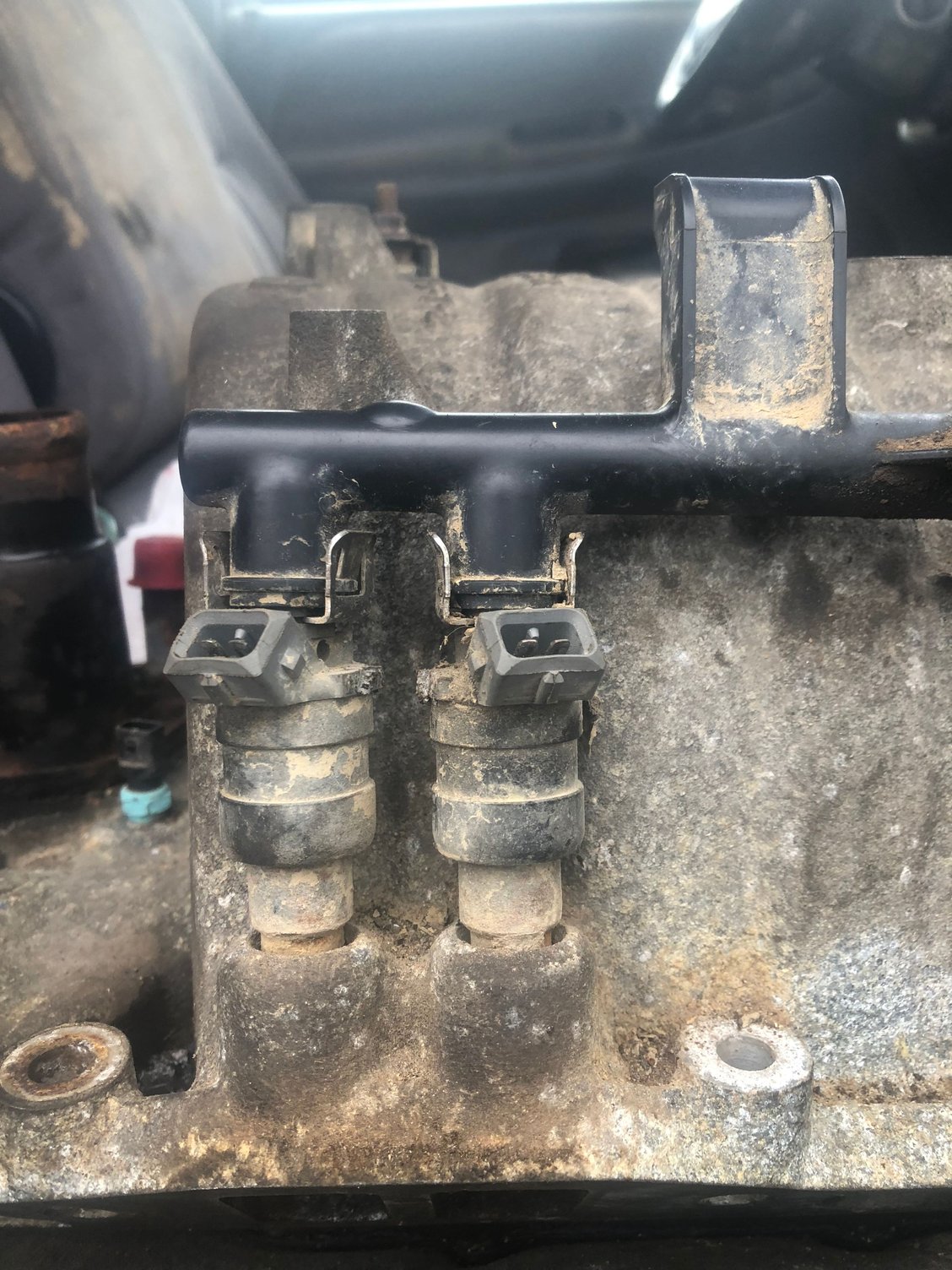

I
got the injector rails switched over, but one of the bolt holes was snapped awhile ago. I got the injectors in as far as I could, on the photos you can see a small gap between them. The left does not have the bolt in it but the right does
Will this be a problem?

I can't say for sure but my truck when I bought my truck and drove it for about a month an injector too a dump on me in the passenger side rail. When I went under the hood it turned out that the driver's side rail had no bolts in it at all and the truck ran fine. So I think you will be fine
