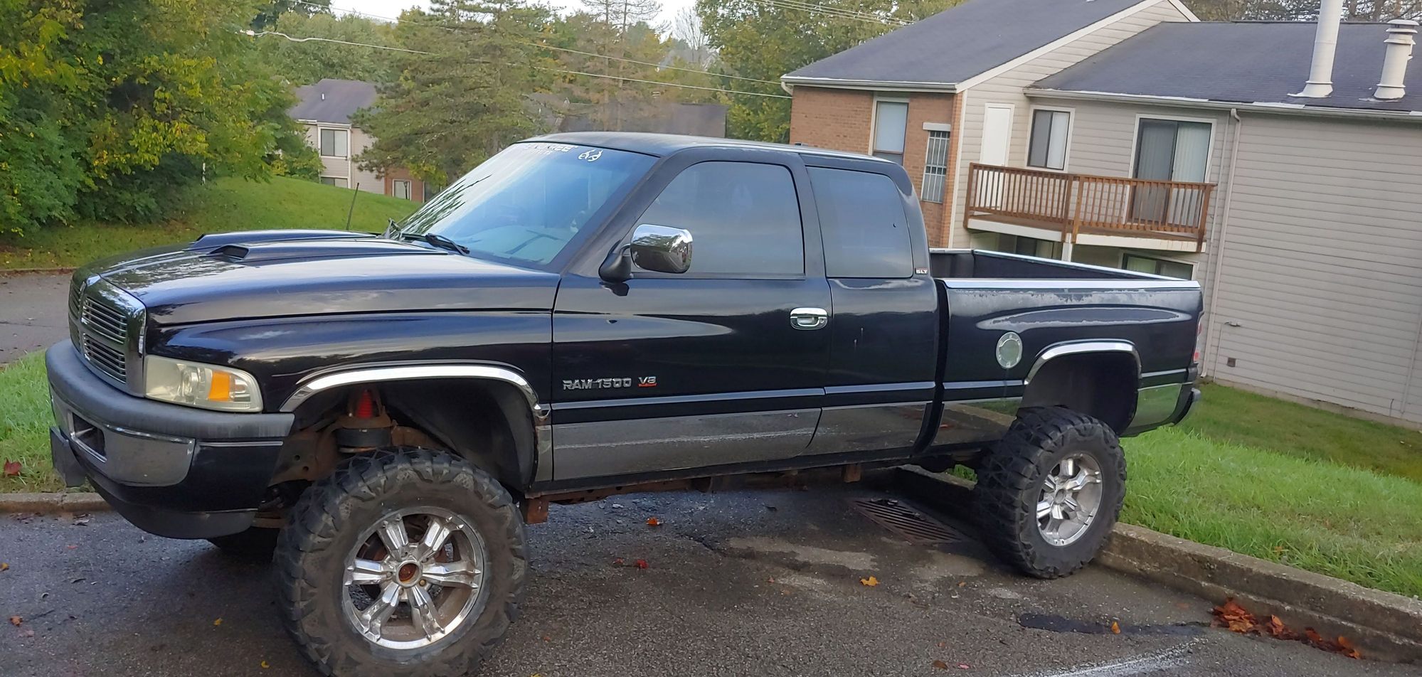

I have a 1996 Dodge 1500 lifted. I'm wondering what to do as far as replacing the dashboard. I've looked all over I can't find a replacement. I see there's covers for it but my dash is a puzzle. What does everyone else do?

What size lift you have on it? And as stated before check lmc
