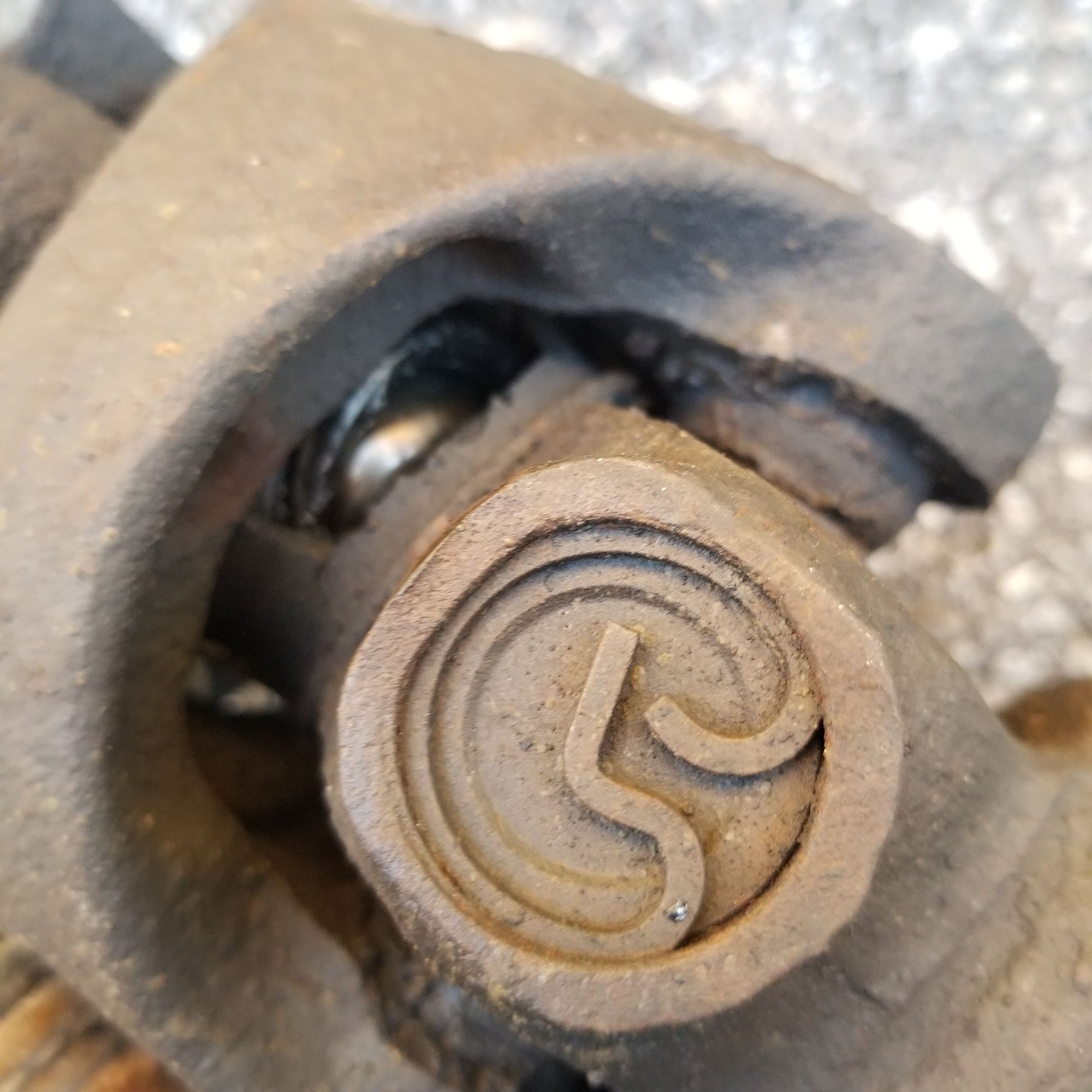

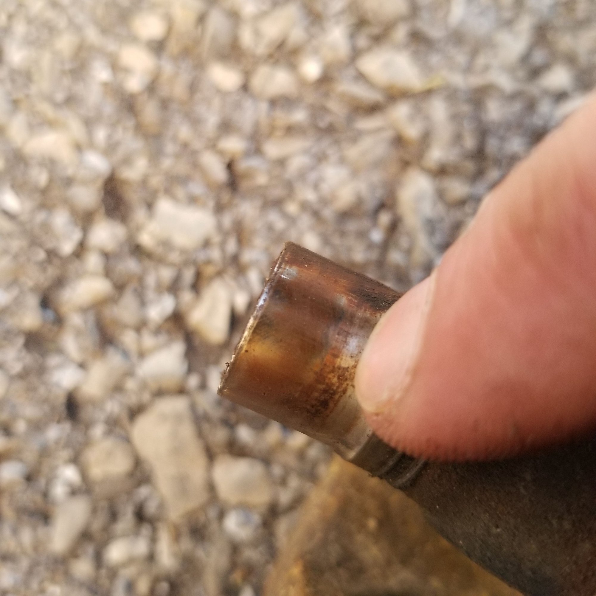

Default Update
Was not the transmission mount. Been fighting this vibration for almost a year. I thought I might need a transfer case index ring but after some angle measurements I don't. So I hooked up my sensors (they detect vibrations and sounds) all over the front end. Since I have a bad and loud passenger axle u joint, it kept saying it was that I(tac welded in lol). I know it wasn't so I installed a new mod. It's the latest and greatest thing...A BLUETOOTH FRONT DRIVESHAFT. I deemed it had to be the front driveshaft either a missing weight or bad u joint (even though they were replace a year ago with Dana ones).
Well while I went under there I noticed my front pinion yolk seal is leaking and I have some seepage from the transmission pan.
So starting taking it off (since I have a permanently locked front axle it was a chore. Take one bolt out, craw out from under the truck engage 2wd, spin the driveshaft until you can get a socket on, crawl out, engage 4wd, repeat 4 times) and the front u joint was stuck like normal. Pryed it off with a screwdriver, and the one cap on the front u joint fell off. Looked dry, even though there was grease in the u joint itself, and the needle bearings had pitting on them and a rust ring on the trunnions (right above my fingernail) the brown color is a LIGHT coat of grease. The needle bearings are to clean to, I didn't even have to wipe them off. The bearing in the double cardan CV ball looks dry and the boot is ripped.
I also noticed some play in the front transfer case yolk, I took a video but it might be normal. Pinion is tight as can be. I will update once I take it for a spin tonight. I think it is the front driveshaft u joints as it didn't look like any weights were thrown off. I wonder if the angle on the driveshaft was to much and was binding, causing pressure on the pinion yolk and thus the seal stretching.
Don't over look the simple things guys, even though the u joints are new and look new, they could still be bad. I think Ramman recommended this to. But the weather was nice (34° no snow or wind which is nice for PA) so I decided to do it.

No vibrations up to 110, even with unbalanced tires! @Ramman18 you were right! Lol. Love this community! Also engaged 4WD no vibrations either so my T-case may be fine yet!
