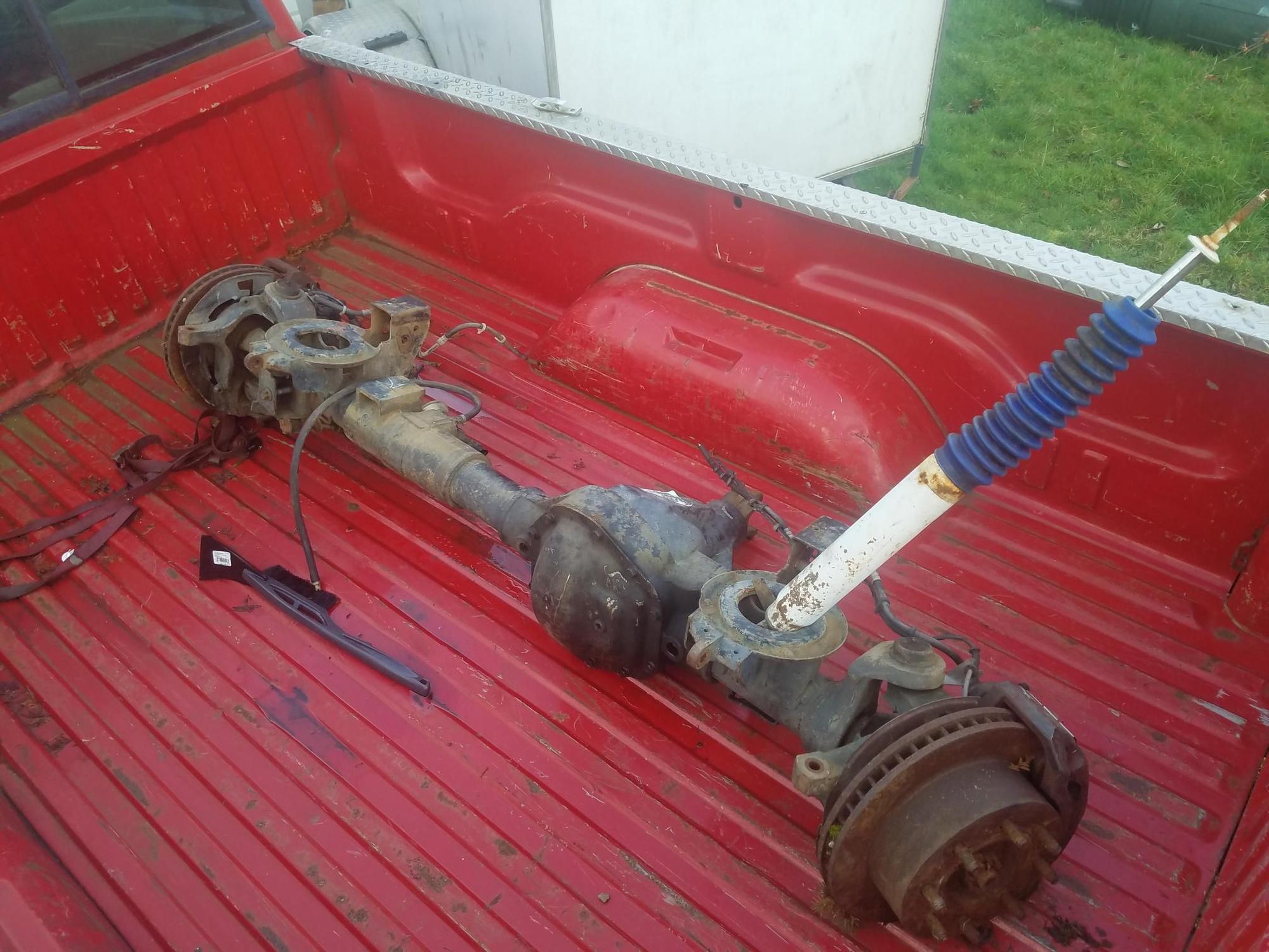

Old Feb 23, 2019 | 11:37 AM
  #45
Ugly1's Avatar
Ugly1
Joined: Feb 2009
Posts: 1,133
Likes: 18
Originally Posted by Wombat Ranger
Did you get this sorted out KevBot?
The guy said he was told it is from an '03 , but it has the CAD. He also said it has 4.88's which is where I want to end up in the end. I didn't pull the cover to verify but I believe the guy probably believes it, otherwise he wouldn't have invited me over to his house. I paid 450 US. Damn thing is heavy.

From: Wild West
100% it's an '00-01 axle. Like I said if I were still out there I would have been tempted to pick that up. Good start to your project. Once you get the rear matched and that installed you're gonna want 37's I think lol. Like I said I wish I could have just gotten lucky with factory 4.10's like yours already has!

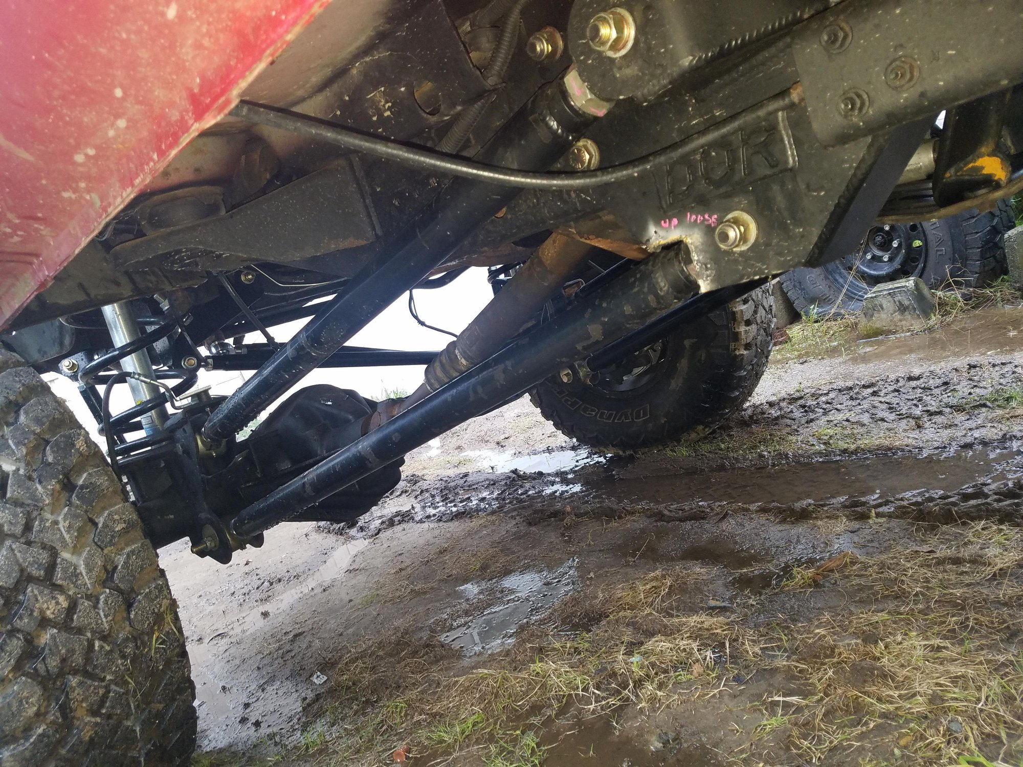

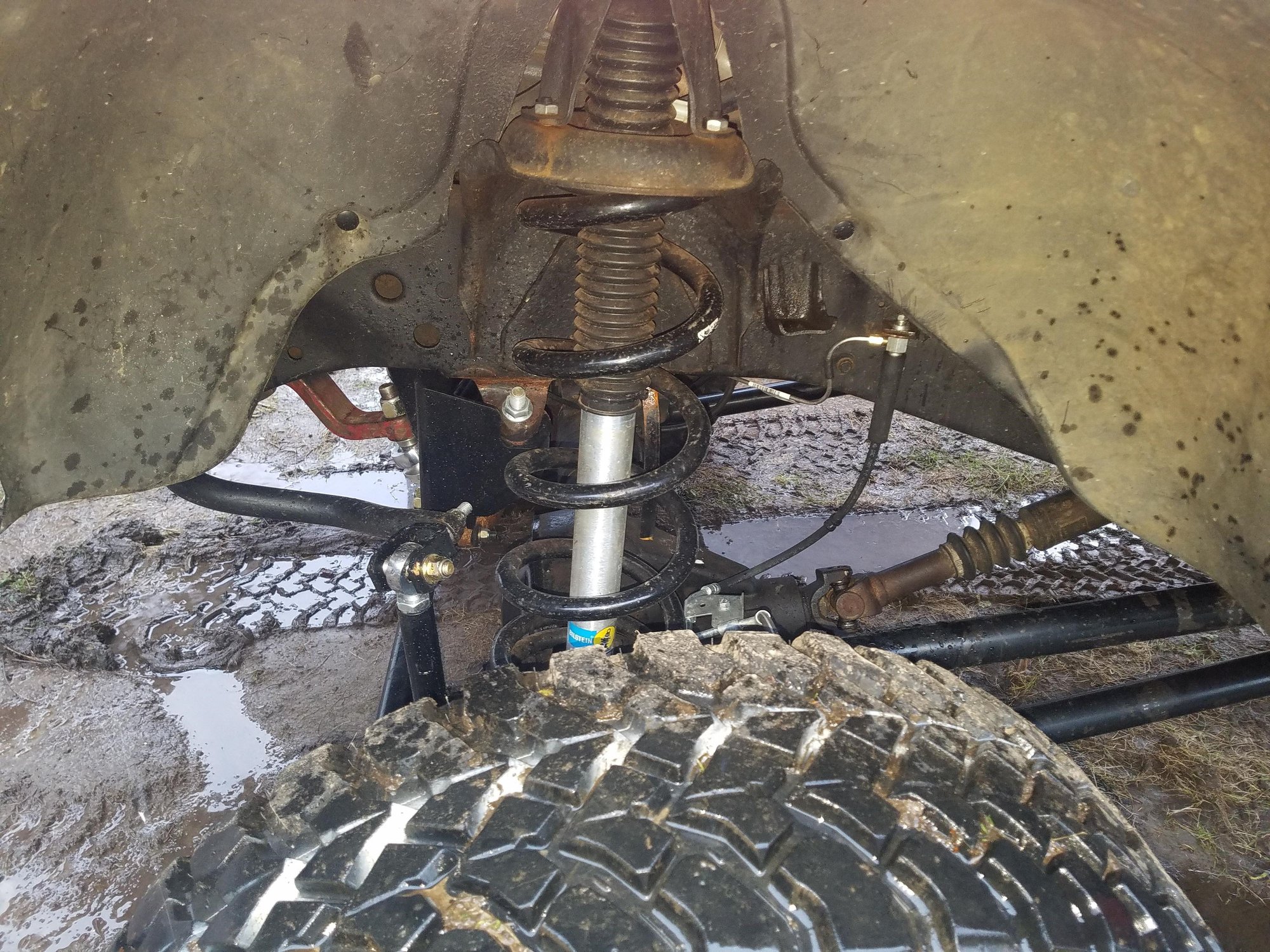

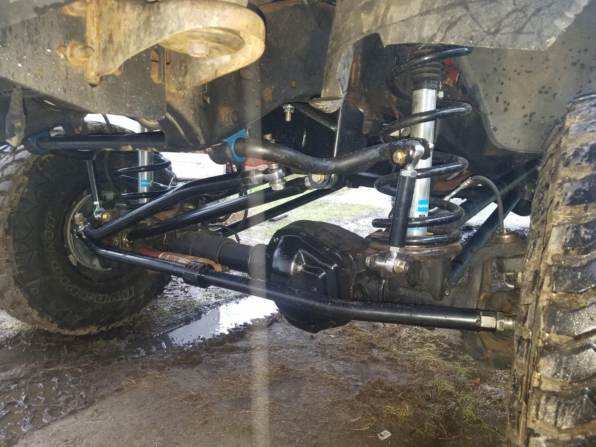

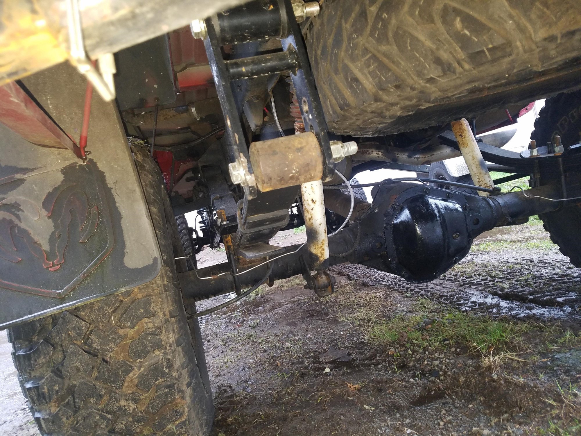

Old Dec 27, 2020 | 01:11 PM
  #50
Ugly1's Avatar
Ugly1
Joined: Feb 2009
Posts: 1,133
Likes: 18
I finally got this back from the alignment shop and it seems trail/road ready. That part of the yard will need some recovery time though. As you see, a brake upgrade ended up getting a bit of feature creep. No more lift blocks or spacers!
