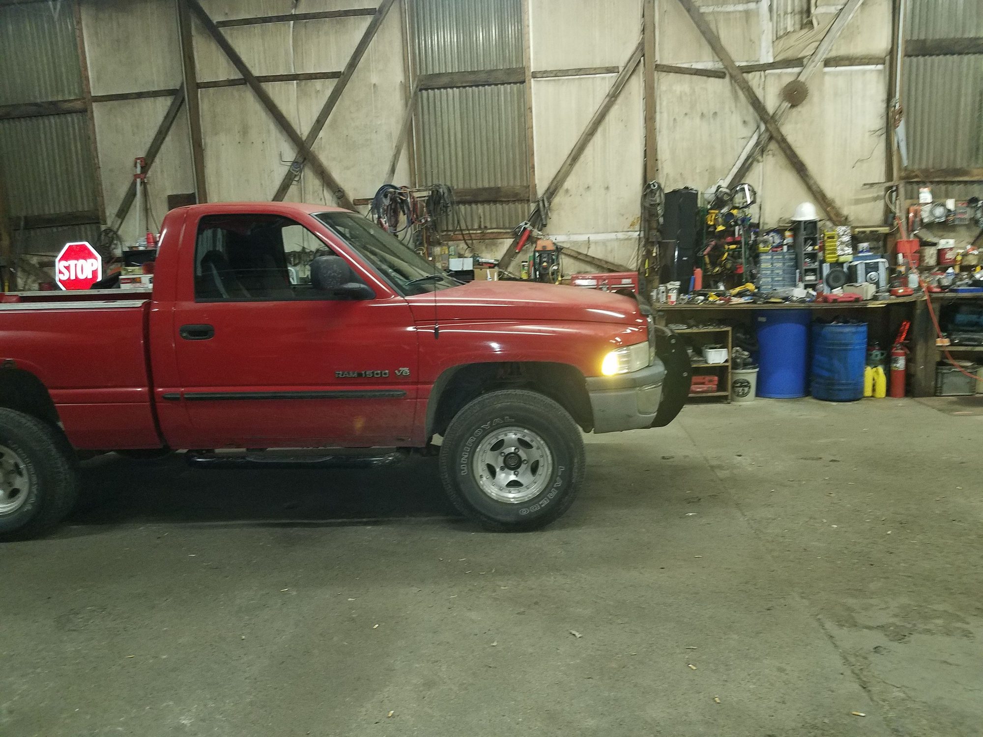

2001 Dodge 5 speed 5.2 4wd

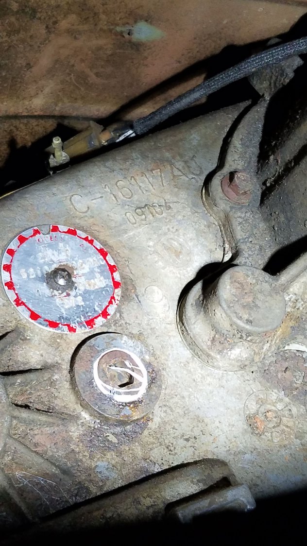

I have a 01 Dodge ram 1500 regular cab short bed. With the 5.2 and 5 speed manual. My transfer case tries to slip into neutral while coasting or high rpms. I have researched and found that I think I have nv231d or np231d and was wondering if transfer case out of an automatic would work or not.

There are some minor differences in the input hub between manual, and auto transmissions, would it work? Possibly. I know finding a truck with a manual trans is difficult, at best.... Could try rebuilding your current case. Not that much goes into it.

I disassembled the rear tail output shaft cover and my snap right and everything looks fine. I can put it in and out of 4wd nust fine no hesitation it's only when I'm letting off the gas while in gear it wants to slip into neutral the transfer case shifter that it.

Probably the nylon pads on the shift fork are worn out/gone.
