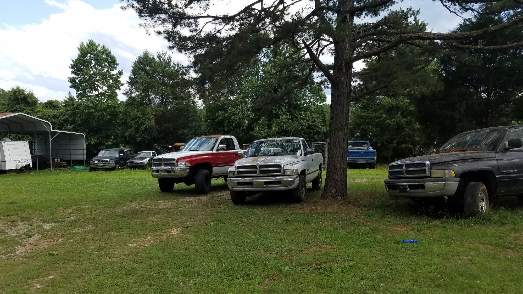

Originally Posted by itsfusion
*disclaimer* I don't even know if this is possible, I recently bought a 2001 1500 and I am wondering if I can run 35s on the stock wheels. I plan on doing a 5 inch RC lift and a gearing upgrade. If anyone has any pictures I'd really appreciate it.
the red and white one is on 35s
