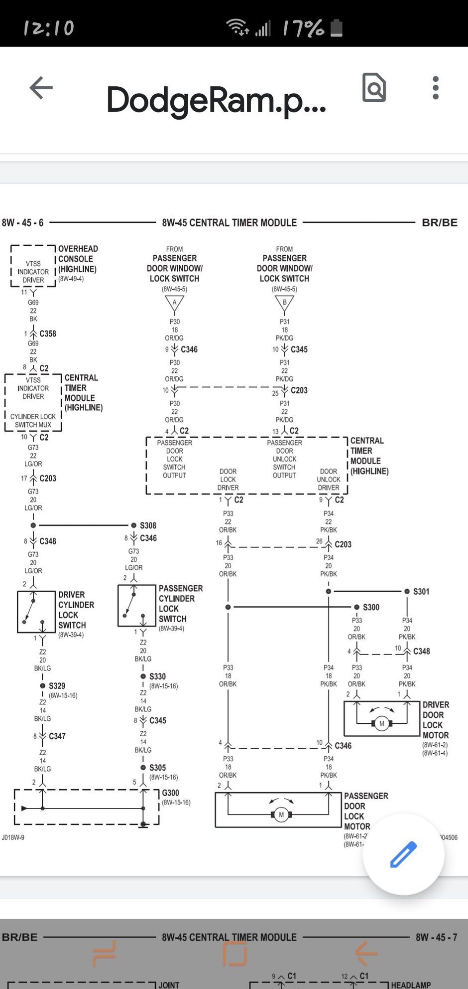

I figured it out 🤗. I'll draw a diagram of how I did it as soon as I get back home tomorrow night. I used the pink/black and orange/black out of the C2 connector out of the CTM with 2 relays. I'll attach the page out of the W8 wiring diagrams that I got my idea from.

[QUOTE=Mark Peterson;3473474]I figured it out 🤗. I'll draw a diagram of how I did it as soon as I get back home tomorrow night. I used the pink/black and orange/black out of the C2 connector out of the CTM with 2 relays. I'll attach the page out of the W8 wiring diagrams that I got my idea from.
Hope this helps someone that is trying to get a remote entry hooked up in their 99 dodge ram. The relay pin numbers are labeled along with the pink/black and orange/black. You will have to cut both wires and off of the CTM side of the wires pk/bk to 87a will go one relay and or/bk to 87a on the other relay then the other side of pk/bk to pin 30 on the same relay that has the pk/bk on 87a and the other side of or/bk to the other relay on pin 30 that has or/bk on 87a and so on attached is my drawing
