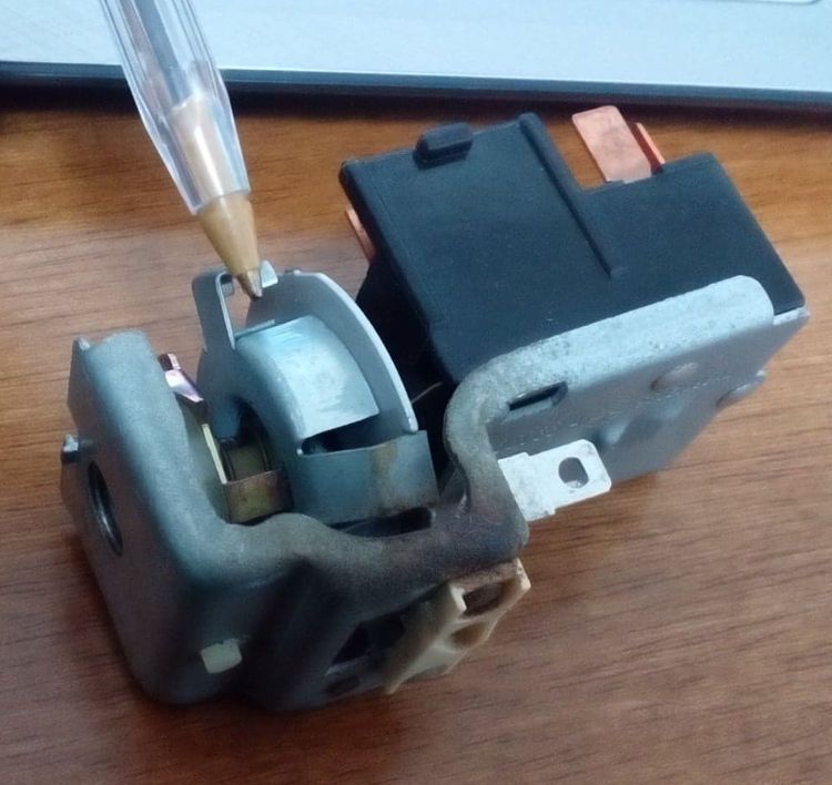

So I finally received my "Digital Laser Infrared Thermometer Temperature Gun" (now that's a long name) and removed the bezel (again) to pull the switch. I left it connected and hanging while the truck was running and the lights were on for about 20 minutes. After checking it with the Infrared Thermometer, the only part on the switch that got hot was the metal rotating part (as per the picture). The heat ranged between ~109-135 degrees depending on how long the lights were on. The rest of the switch (black plastic parts) and the surrounding metal didn't warm up at all.
The wiring and the connector didn't get warm either. I should have pulled the connector off to check terminal "H", which is the headlight terminal, but decided not to do that. I wish I did since the dash was already apart, but I didn't.
Note: The picture below is the old part I originally replaced, which is why it looks rusty. The actual test was done on the newly installed switch.
Anyway, I think I'm more comfortable now knowing that the wiring, connector and the switch upper parts are not getting hot, as those were the parts that burnt and melted down. So with that said, I'm good to go.
