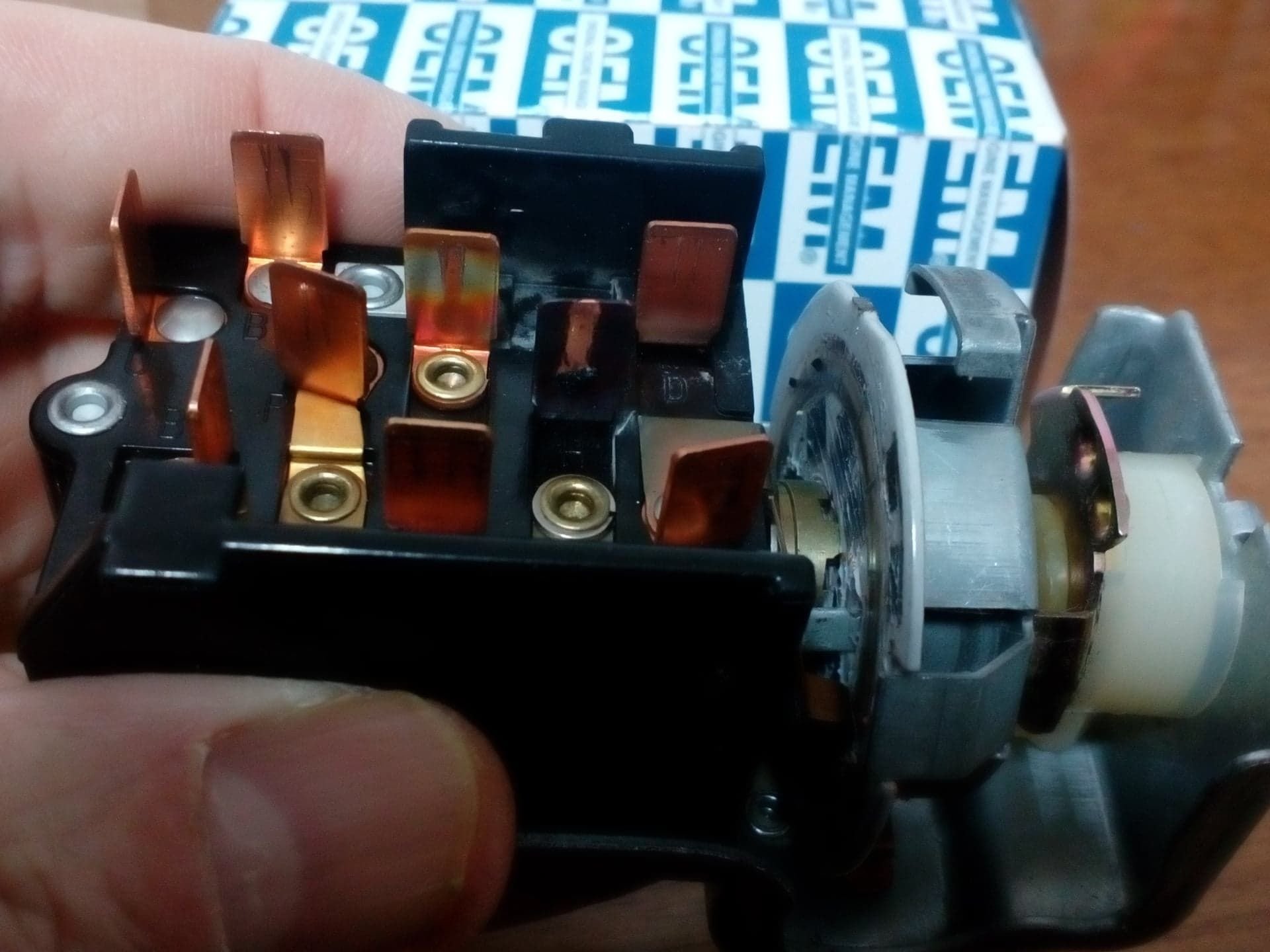

Thank you everyone for your input and advice on installing the relay harness kit, as well as changing out the bulbs, which will be my next steps. I've just competed installing the new harness and switch and all is working now. Here are photos of what I took out. Looks like the switch may have been the original. The burnt parts of the harness and burnt terminal are letter "H", which is for the headlamp.
Here is where the side of the harness melted out.
You can see towards the right, one of the terminals is burnt.
Looks like an original part.
The plastic on the harness is melted around the clip.
