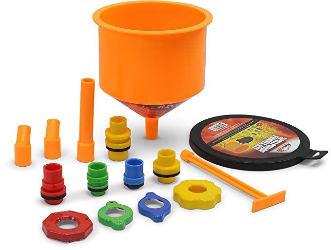

Get one of these, had the same issue on my sons truck. Drain your radiator and refill with this funnel, gets all of the air pockets out. Changed the water pump, temp sensors, thermostat (drilled hole) and radiator hoses on the truck, wasn't showing hot, but bottom hose was cold, so nothing flowing through the radiator. Refilled coolant with this thing, no more issues and good flow through bottom hose.
https://www.amazon.com/EPAuto-Radiator-Coolant-Filling-Funnel/dp/B01I40ZQWE/ref=asc_df_B01I40ZQWE/?tag=hyprod-20&linkCode=df0&hvadid=198151843411&hvpos=1o1&hvnetw=g&hvrand=12222288785259839570&hvpone=&hvptwo=&hvqmt=&hvdev=c&hvdvcmdl=&hvlocint=&hvlocphy=9011641&hvtargid=pla-381147636217&psc=1 https://www.amazon.com/EPAuto-Radiator-Coolant-Filling-Funnel/dp/B01I40ZQWE/ref=asc_df_B01I40ZQWE/?tag=hyprod-20&linkCode=df0&hvadid=198151843411&hvpos=1o1&hvnetw=g&hvrand=12222288785259839570&hvpone=&hvptwo=&hvqmt=&hvdev=c&hvdvcmdl=&hvlocint=&hvlocphy=9011641&hvtargid=pla-381147636217&psc=1
