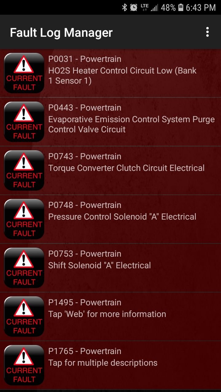

I had a tree jump out in front of me a couple months ago and it didn't move. My right front headlight pretty much got pushed all the way to the firewall. Looking at the truck I thought it wasa done deal. But winter was coming and buying a different truck wasn't in my budget so I headed to pick n pull. Surprisingly I got the truck back together for $400. But I have some issues. Alternator not charging. So to get by I got an external voltage regulator to charge the battery. The main problem is my transmission. It's in limp mode. I only have 2nd and 3rd gear and i have to manually shift. The transmission relay is not switching. I've checked continuity between the pcm plugs and the relay and alternator. Their good. But im thinking the pcm may have gotten jarred and broken some solder points off the board. I guess before I commit to another pcm I thought I'd see if anybody had any suggestions.

so I probed the signal wire for the relay and it lit right up. Checked the socket that the relay plugs into and it lit right up. Plugged the relay back in and cleared all the codes and it fired up with only one code for EVAP which is expected and not an issue I'm worried about right now. Took it for a drive and not only does it shift fine again, but the alternator is once again charging. I have no idea what was wrong or what fixed it. I've had those 3 plugs out of the ecm numerous times. Lol. Im not complaining. I think it knew i was on the right track and decided to get right...
