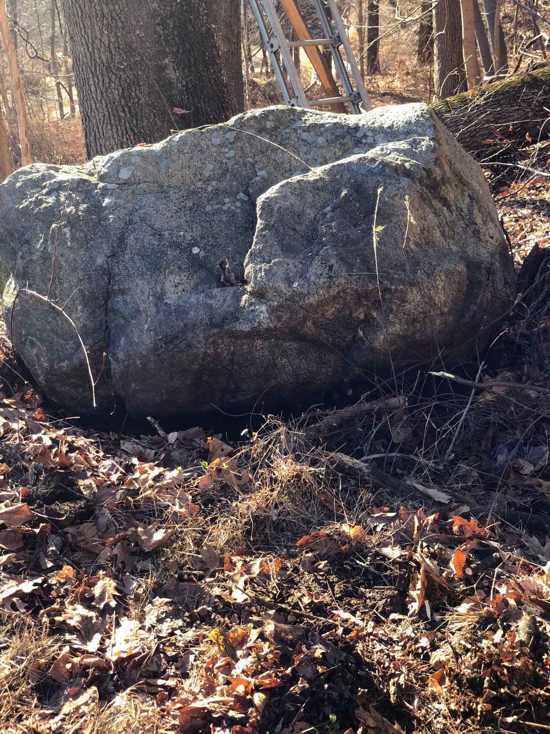

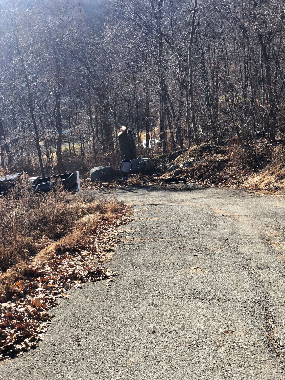

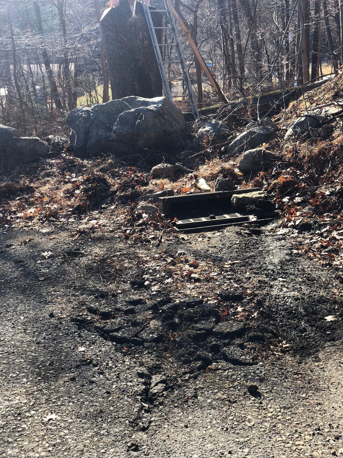

I had had my trailer hooked up to the truck with a car on top, when down my friends mountain of a driveway. I went to slow down and eventually the wheels locked up and the truck and trailer slid about 30 feet until my passenger front wheel smashed a sewer drain/curb and then my front end blasted a monster boulder the size of car and moved it a foot. That boulder kept me from going over a clif...
my friend had a backhoe and was able to pull the whole rig set up back up the driveway with a chain. It was crazy and believe it or not the front end doesn’t even look like it was touched. The front bumper brackets got a little bent but this is what I need help with!
