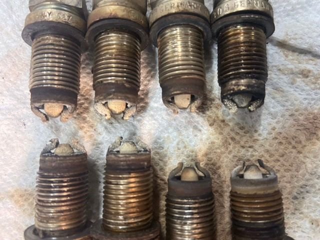

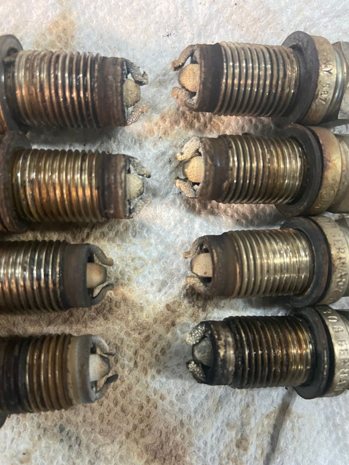

Pulled these out today as part of my intake plenum repair. They are Bosch Platinum B3 almost 14 yrs old and 140,000 miles. Plugs at 5 and 7 are still in pretty good shape.
These are laid out as they sit in the engine. Cylinders 1,3,5,7 on the left and 2,4,6,8 on the right.

Looks like #2 might be burning oil, the rest look fine

how ‘bout now?

Assuming 2,4,6,8 across the top.... the first three show evidence of burning some oil, number 8 though, is oil fouled. The odd number cylinders aren't quite as bad, but, got some oil burning going on there as well. Think I would be taking a long hard look at the plenum, and probably valve seals as well.
Yes those are 2,4,6,8 across the top. ( If I don’t use “actual size” when uploading, my pics rotate 90 degrees left and apparently some of you can’t see any pic in my original post) I assume you can’t see them either. Anyway to fix that on my end?

+1 for vlave stem seals...blue smoke on start up?
