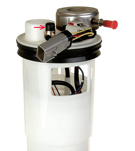

On My fuel pump there is a siphoning port for draining the tank.
