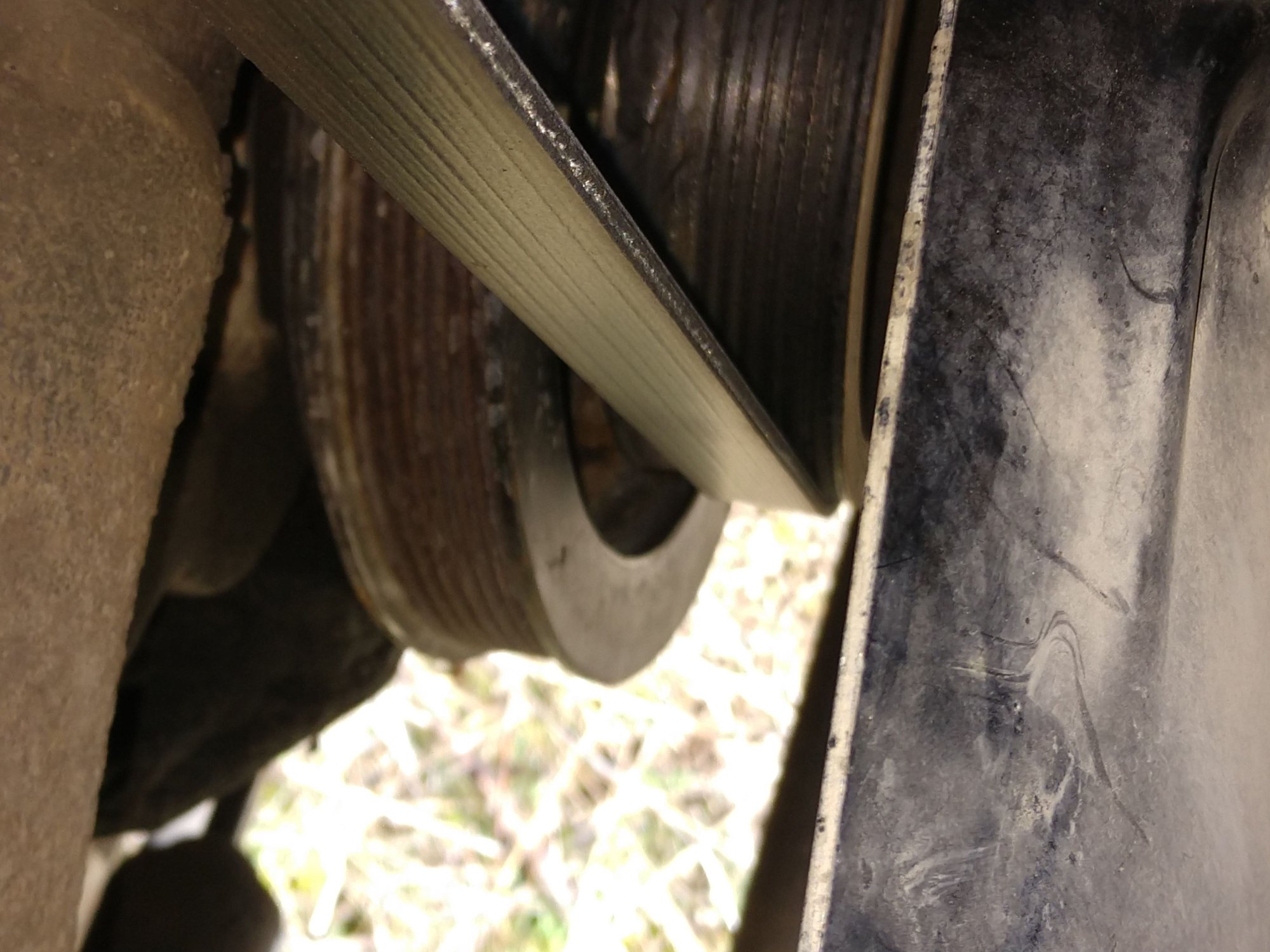

Awesome 👍!, Thank you, I actually have a picture of the pulley separated
Slipped off the back and was able to get a smaller belt around the center portion after repositioning the tensioner with a little modification and bypassing the seized smog pump and swapping out the idler and tensioner pulley for different sizes
