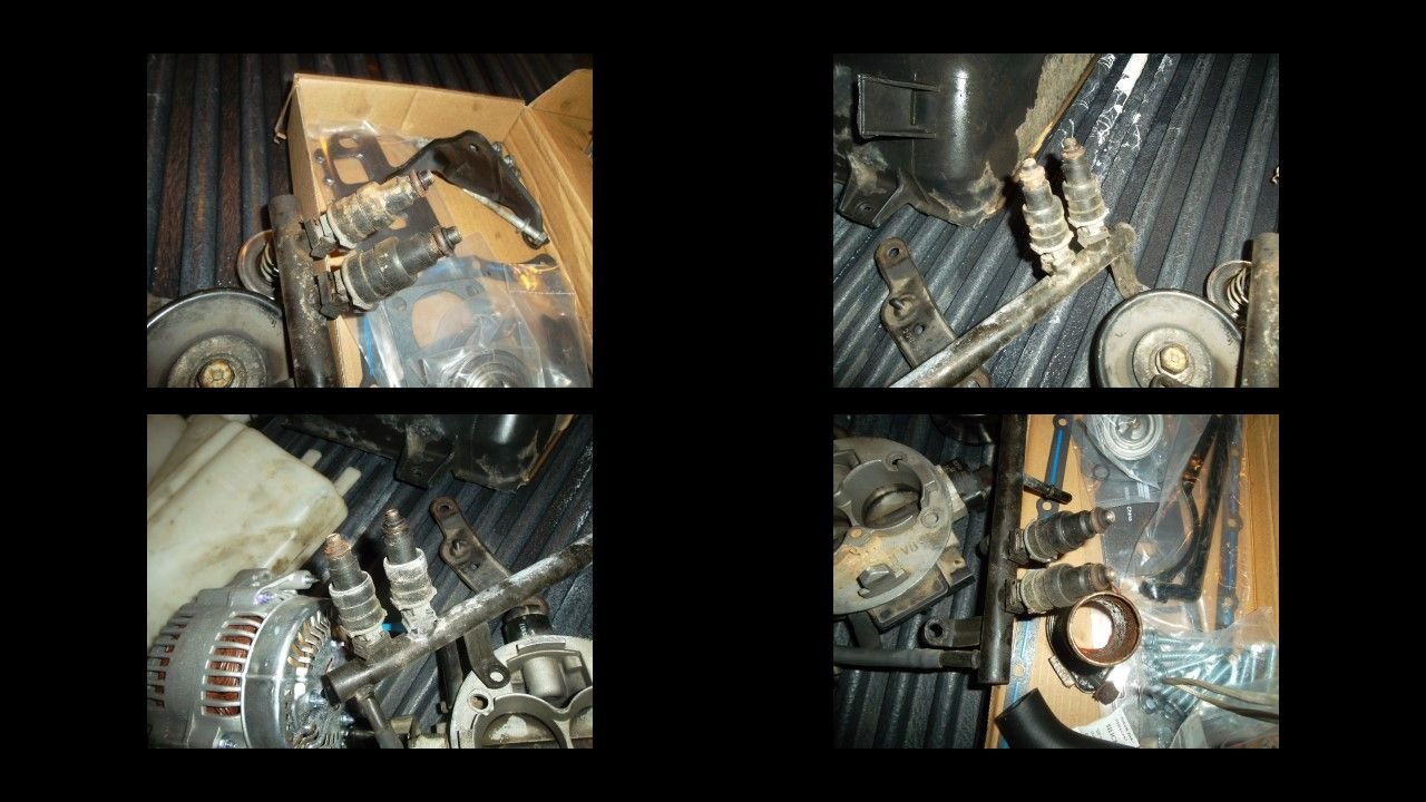

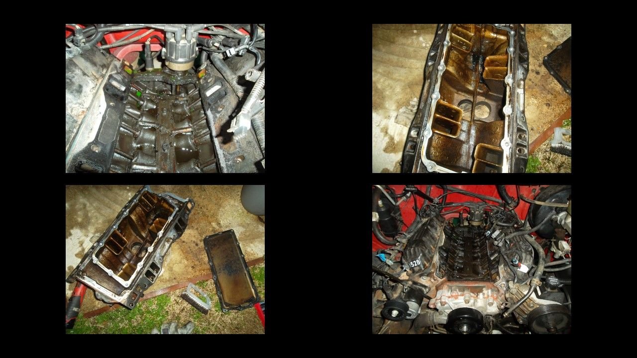

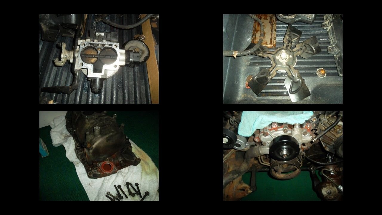

Update: I have taken everything off and am wondering what I should do next.
I could not find the other sensor for that connector, I will take a picture of the intake again and so hopefully one of you can tell me where it is. For now here are the pictures of what I am dealing with. Thoughts? I am going to replace the gasket for the plenum, and obviously all the bolts and related gaskets with what I have removed.

Here are the pictures:
Intake and Top of Engine
Fuel Rail With Injectors
Bottom of Throttle Body, Bent Fan, Intake, only one temperature sensor is broken, the second on the top had a connector, still do not know where other plug went. Also the engine with new water pump by previous owner, gasket looks ruff, should I do something about it?

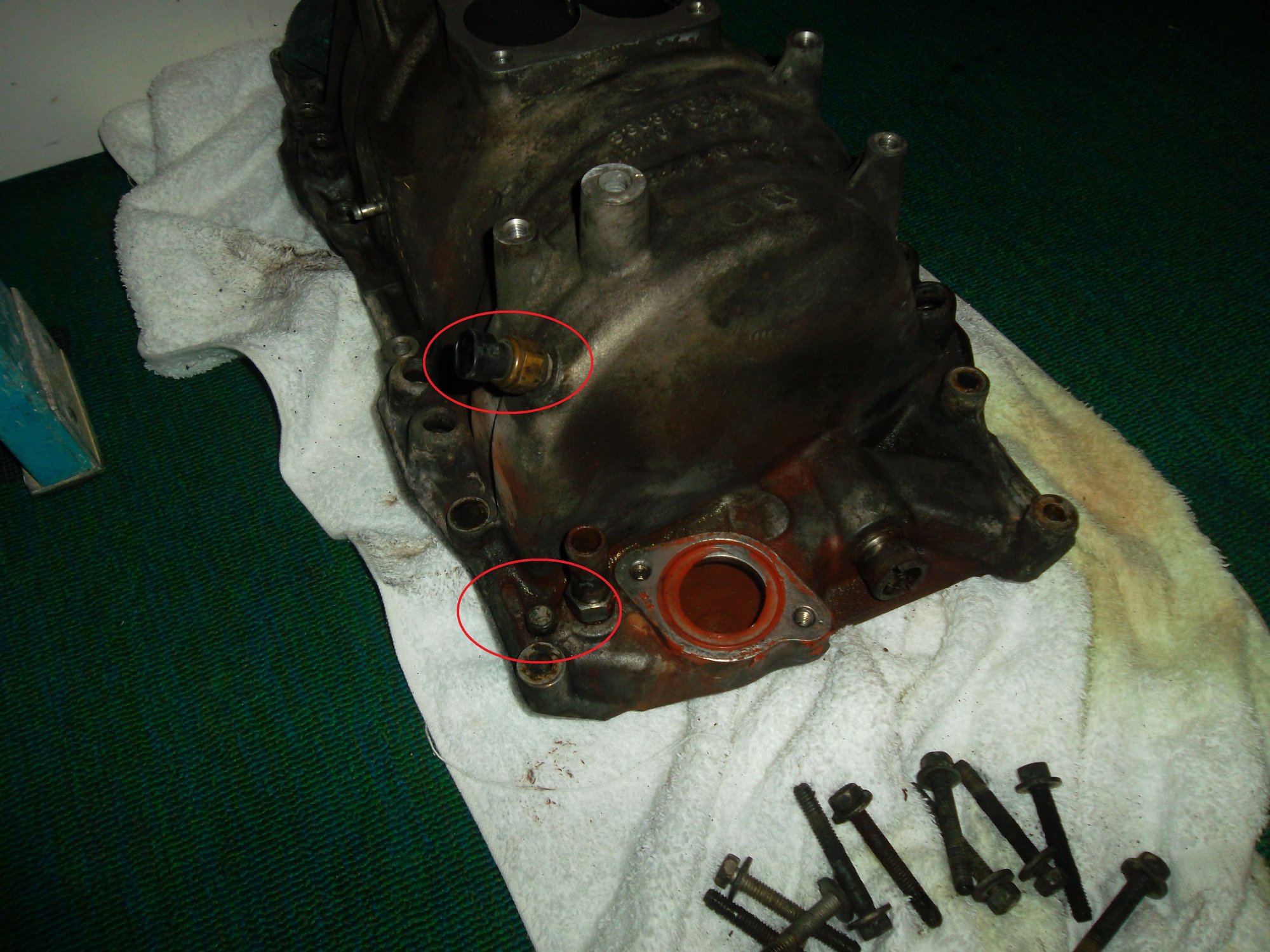

Wink Intake Sensors One Had Connector, other Didn't
I have circled the two sensors on the intake, the one on the bottom is as previously stated, broken. The other on the top had a connector on it, therefore there still leaves another connector of the two wire sort.

I can see the one sensor there next to the hole for the thermostat. There *should* be another hole, just behind the thermostat housing there.
Is the sensor that is there, one wire, or two wire?
Old Mar 3, 2020 | 09:13 PM
GrayHat's Avatar
GrayHat
Joined: Feb 2020
Posts: 26
Broken one had one wire. I did not see another whole for another sensor by the thermo housing.

That intake is the wrong one for that truck. Previous owner must have replaced it...

get one from a junkyard. If it's the one wire sensor that is missing, it's no big deal, just won't have a temp gauge in the truck. You might be able to tap into the 2 wire gauge to get a reading
