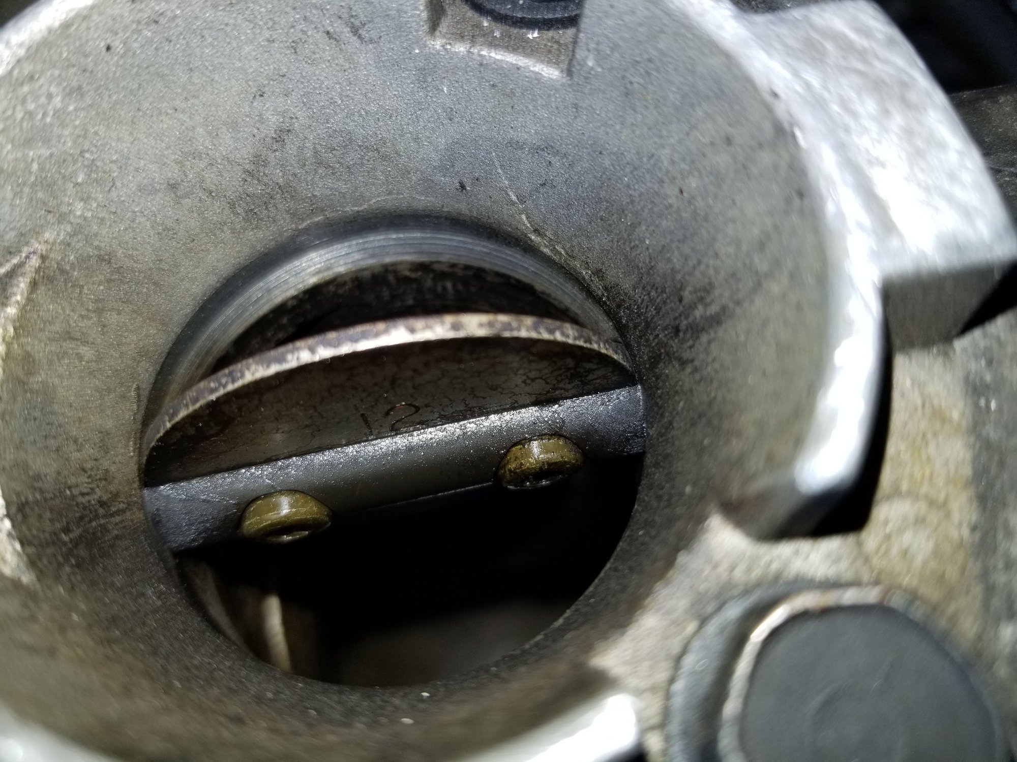

I took the throttle body off and it seems to be blown out on the drivers side. I'll post a link to the video on YouTube. Also oil pooling in back of plenum.
considering one side of the gasket is pushed inside the intake more than the other, I think it is plenum. What do you guys think? Thanks

There are some tests you can perform, don't remember the details (search the web) but basically if you see vacuum in the crankcase the plenum gasket has failed.
Old Mar 26, 2020 | 05:52 PM
Posts: 87,480
If you can see the gasket pushed in, and oil pooling at the back of the intake, the plenum is blown..... Time to yank it.
