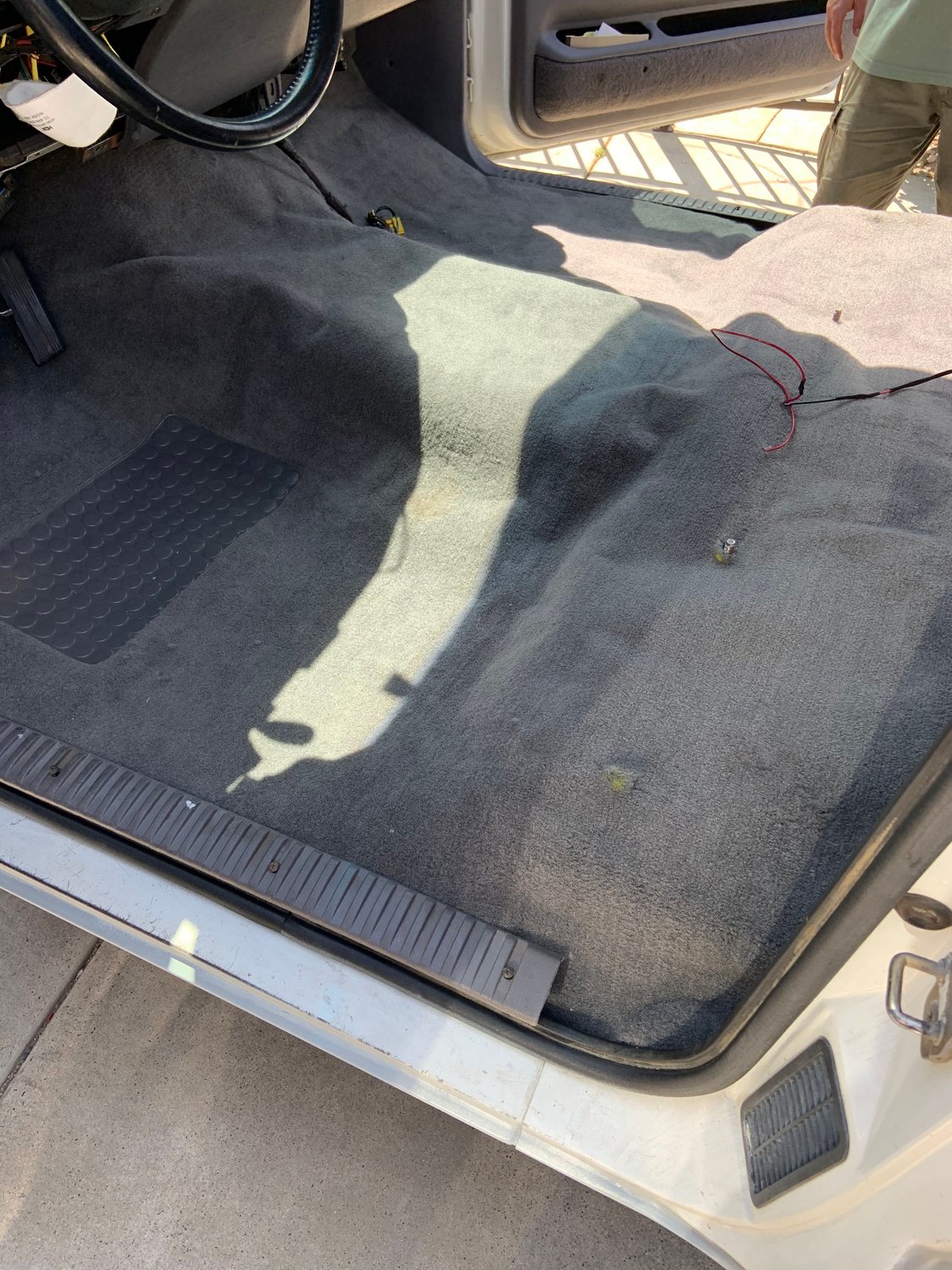

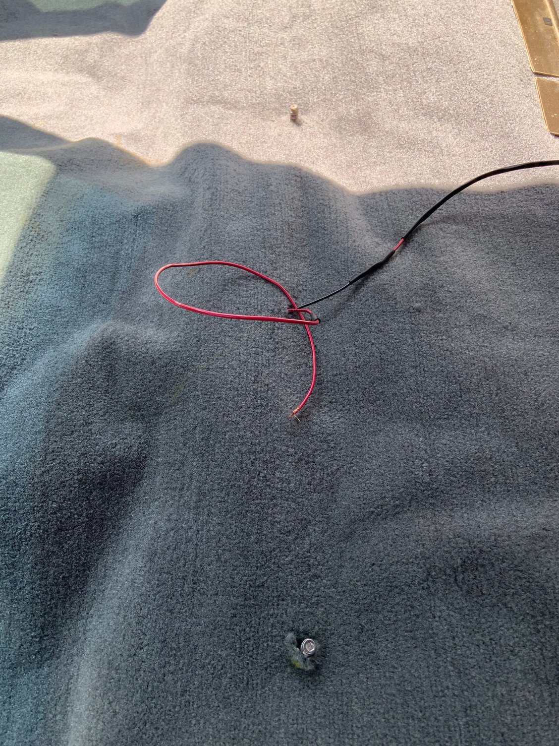

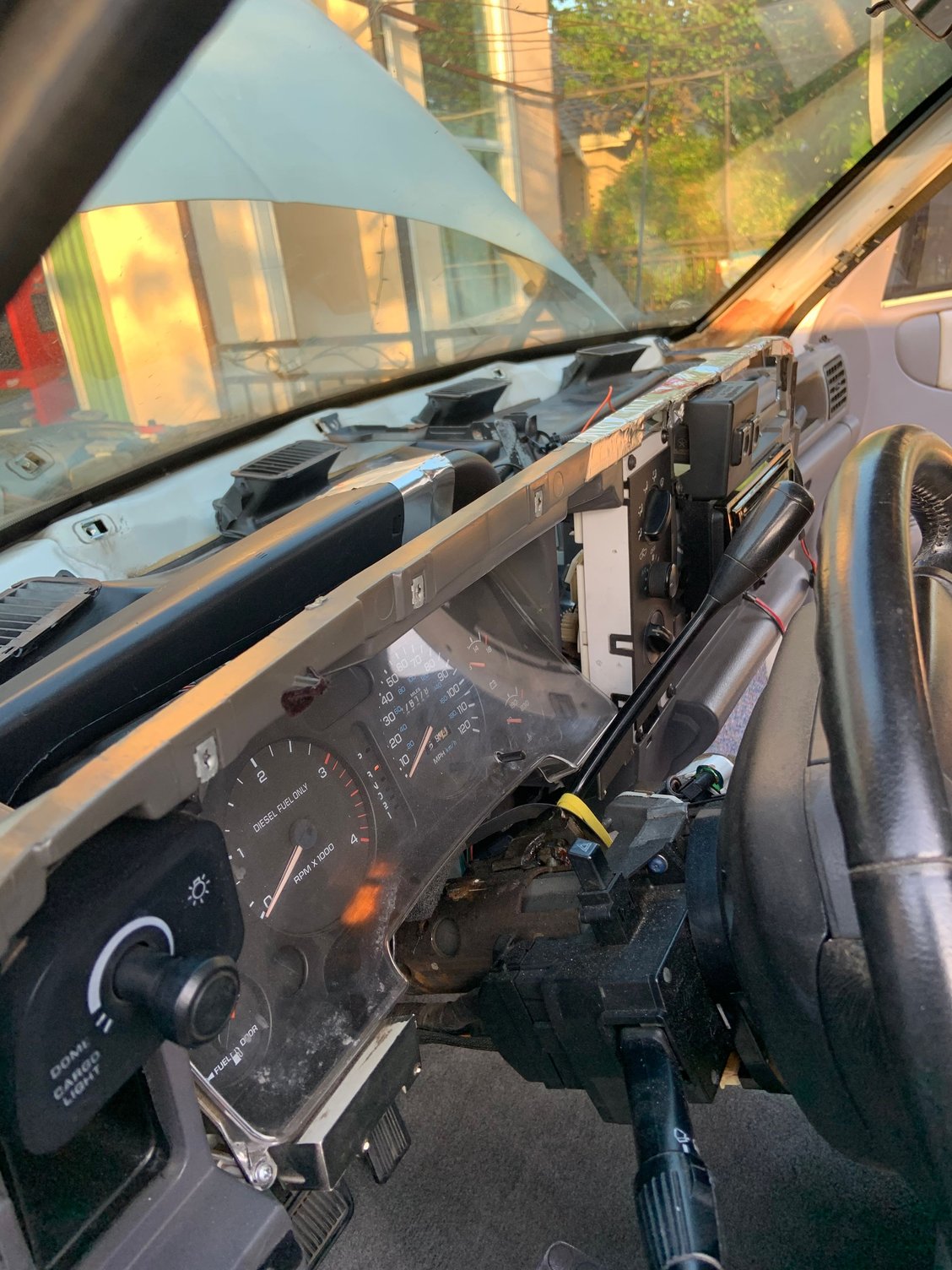

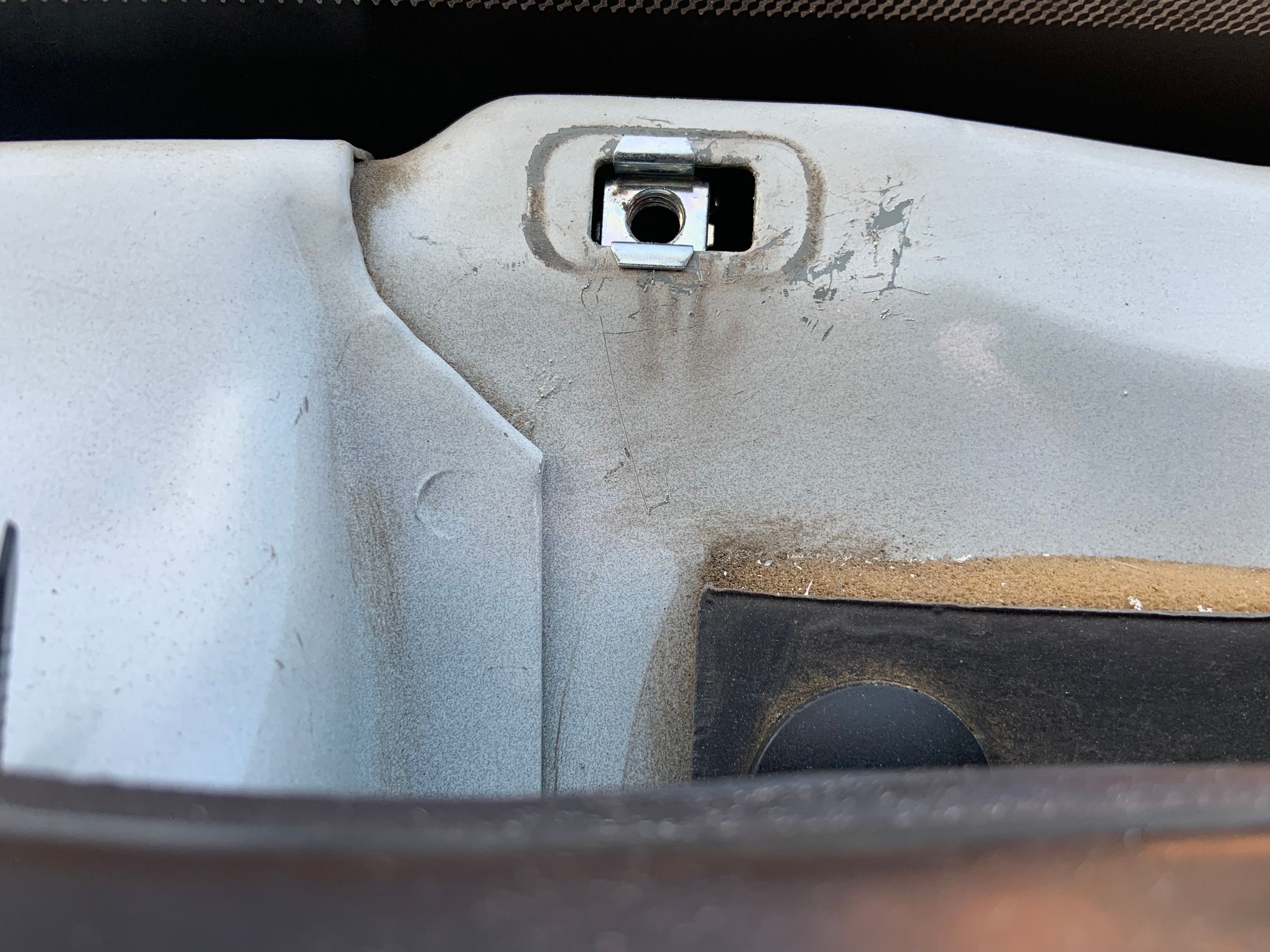

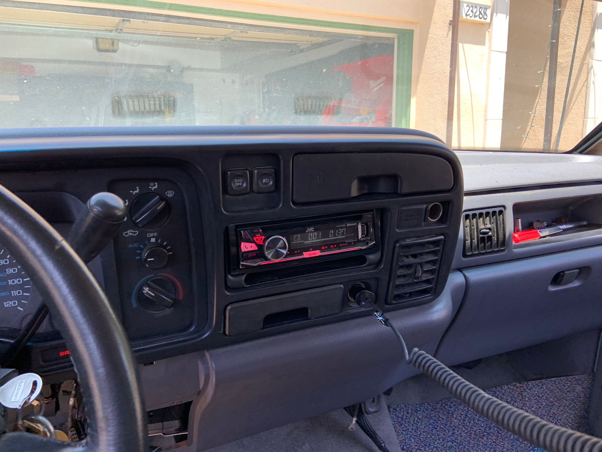

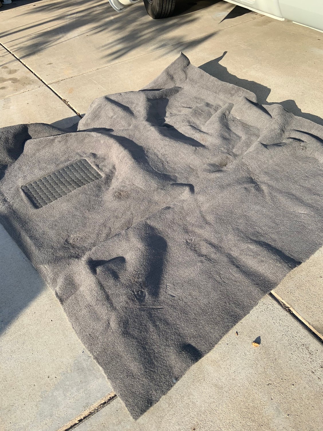

Finally got back to the project. Buttoned up the interior today. I still need to stain the console and finish up the carpet.
For the dash pad, I used square nuts instead of the stock fasteners.

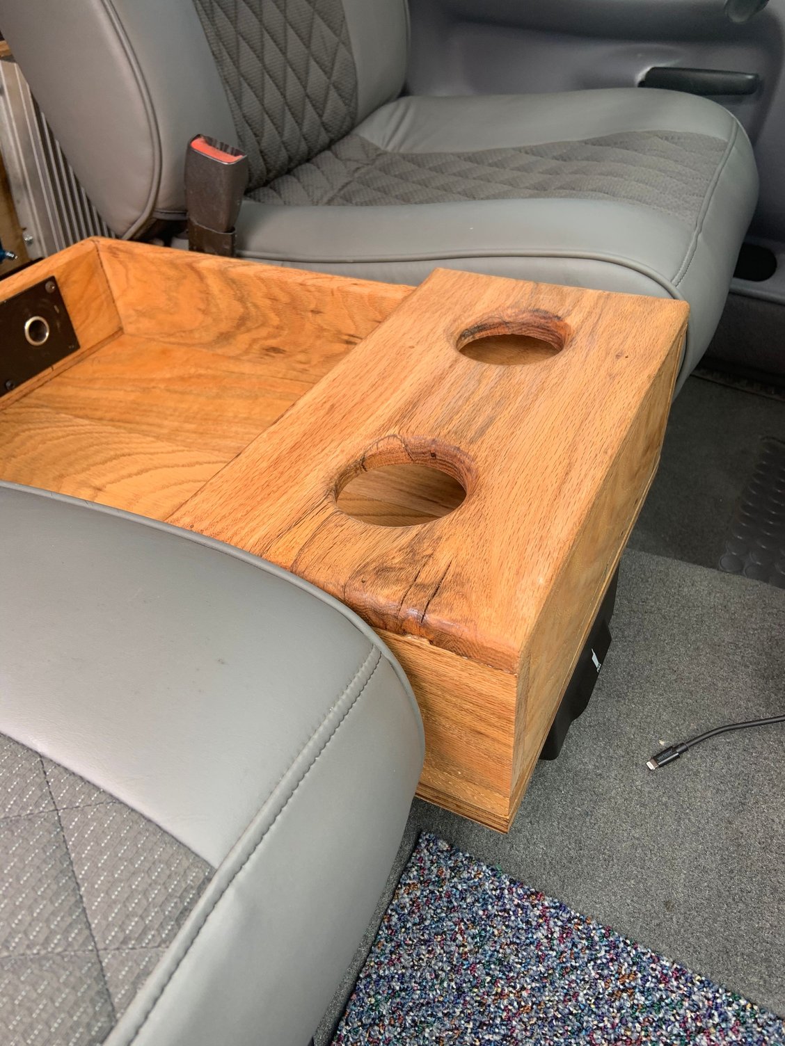

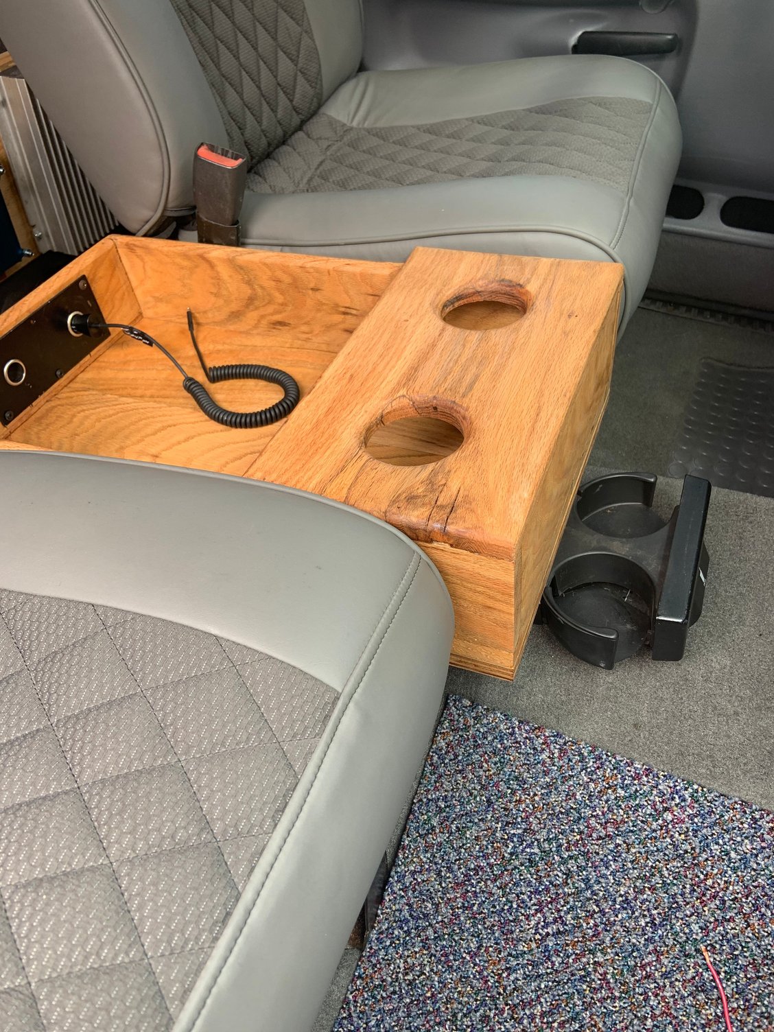

Just finished the center console. Still need to do some little tweaks, but it’s a practical addition.

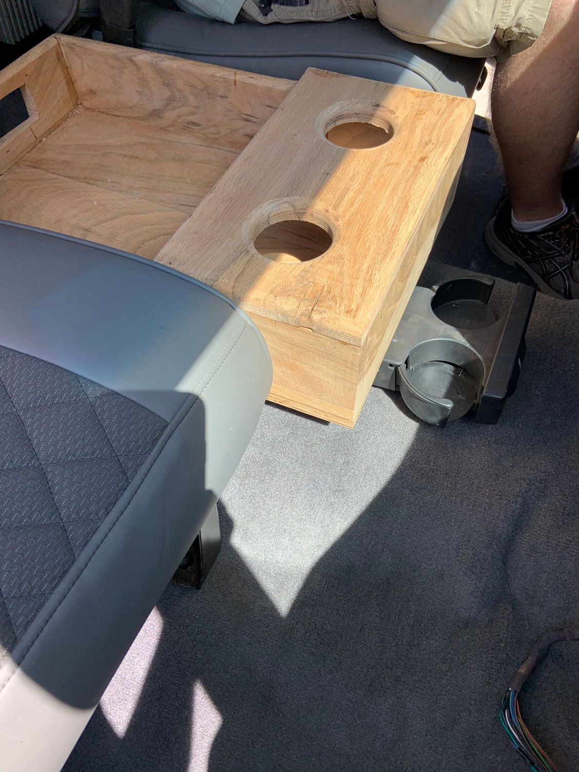

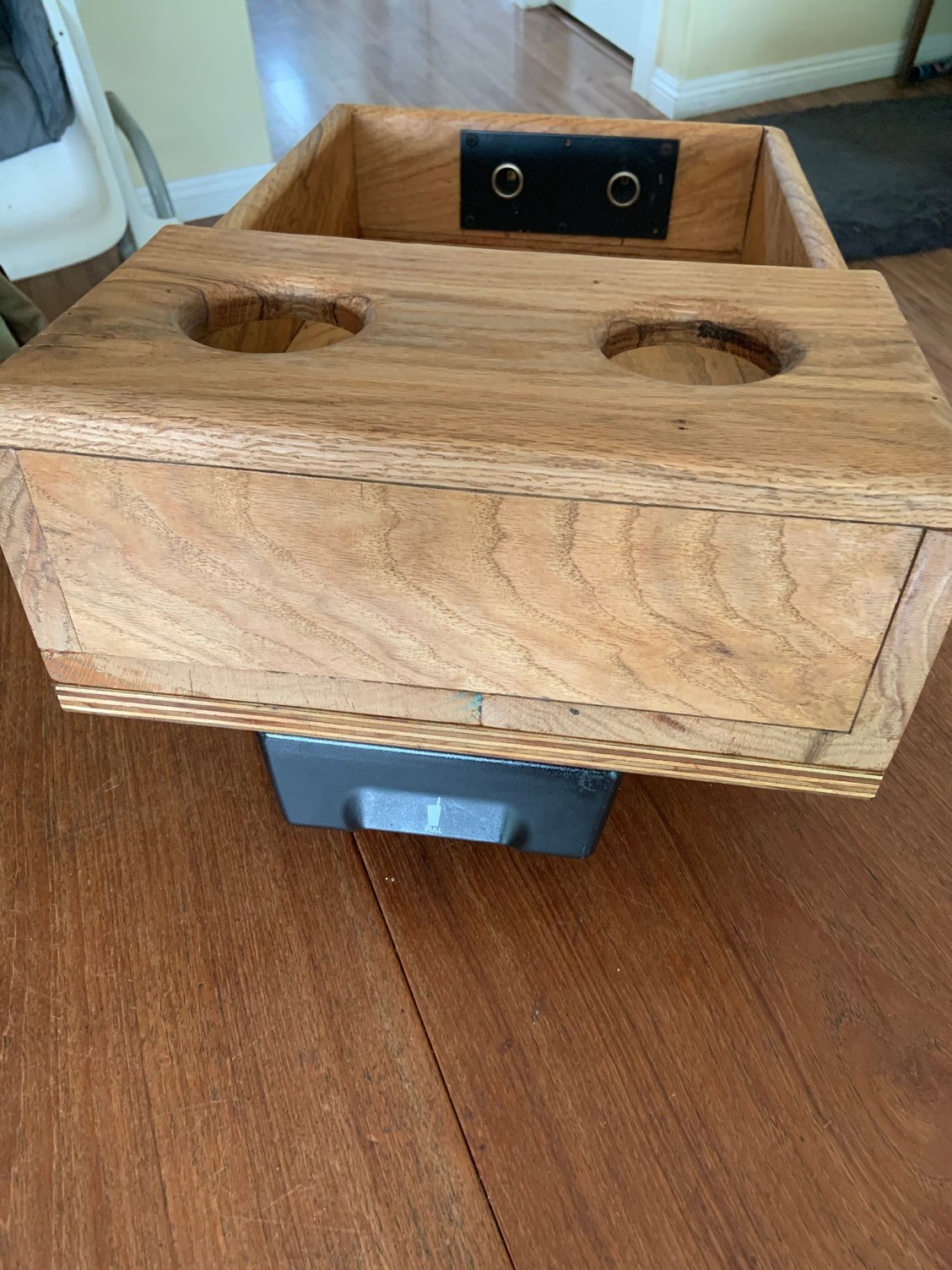

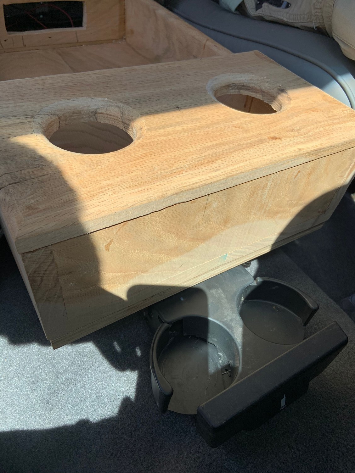

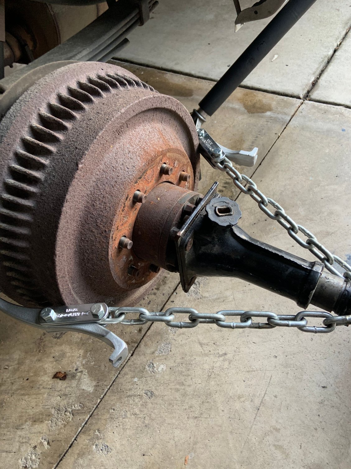

Don’t know if this will help anyone, but had a hell of time pulling off the rusted drum to swap a wheel cylinder. Rented a 7 ton puller from auto zone, but it was too small, but by removing the jaws and putting them on some chain in the garage, I used a jack from my wife’s car to break it loose.
