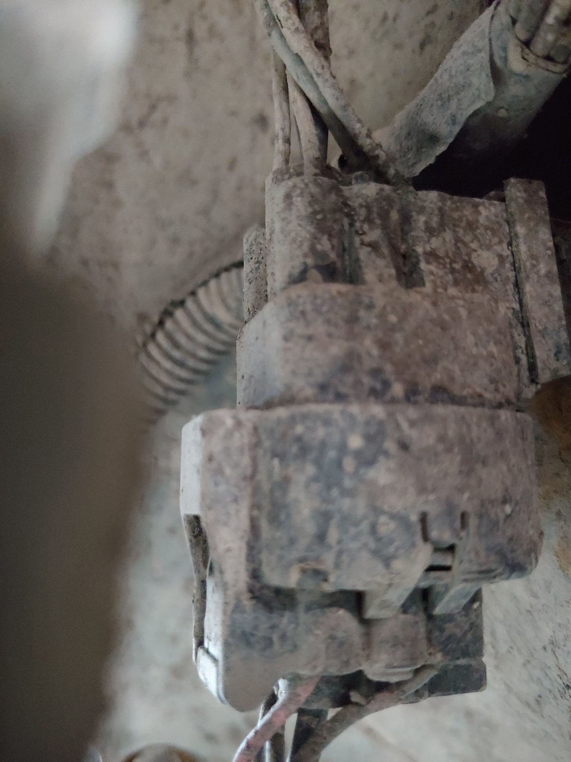

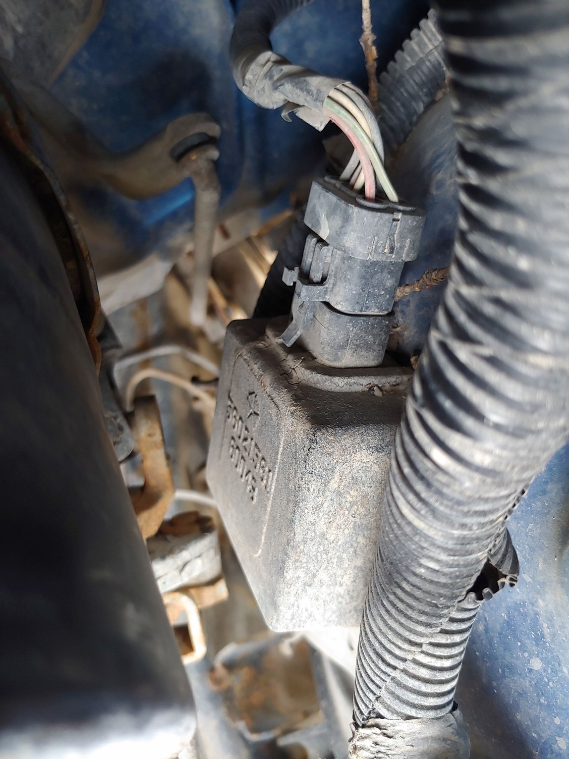

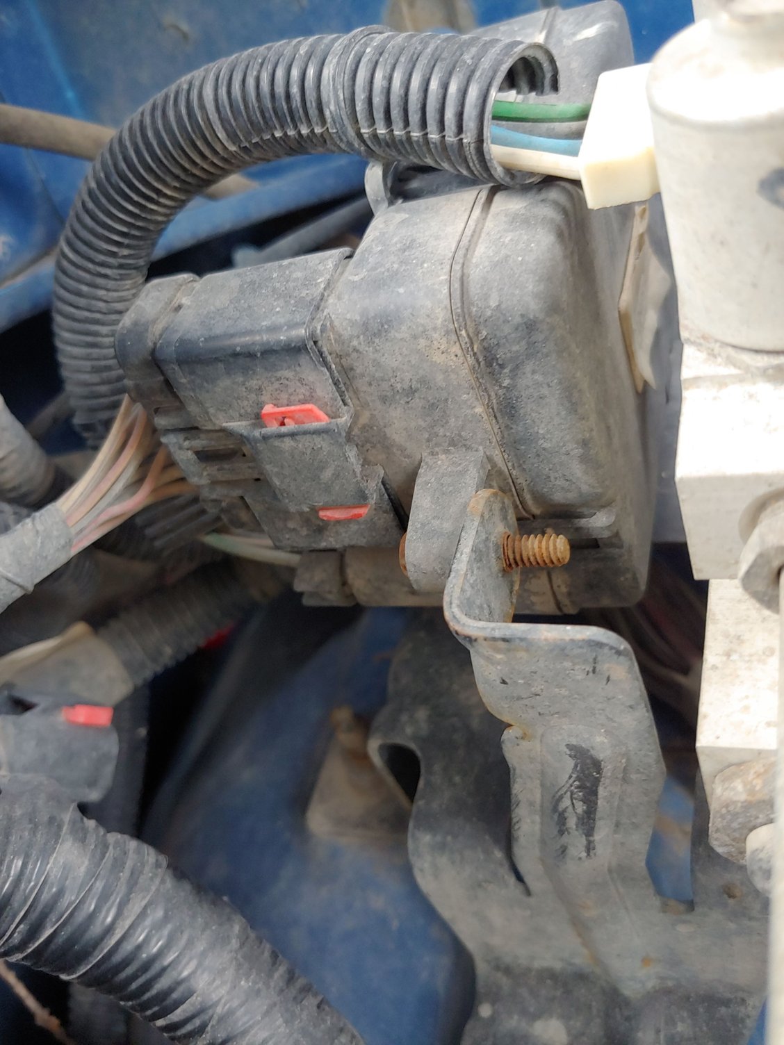

Ok I'm stood by my truck right now. 98 5.9 gasser. From the first branch I have one plug that goes to my under hood light, one goes to an 8 pin part attached to the wheel well, and then one goes under the truck and branches into these 2 connectors.
Then the second branch of the harness goes to washer reservoir and the brake system.

Alley, can you take a pic of the 8 pin part attached to the wheel well please? I think this is where I need to plug in my 14 pin connector, but after the frame swap whatever used to be on the wheel well is no longer there.

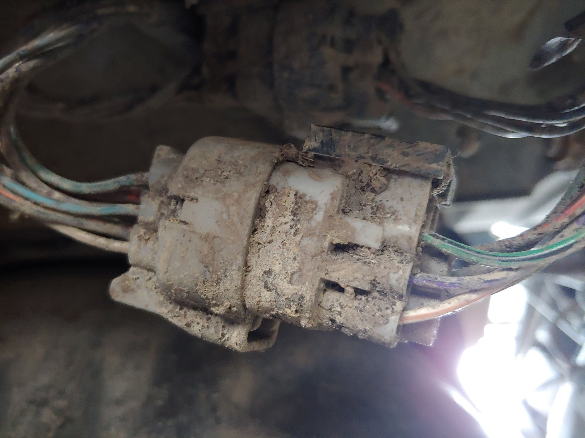

First one is the brake module connector, second one is the mystery part I don't know about (I think something to do with DRLs?), And the third is a loose connector I have hanging there.
2nd one is DRL module and the 3rd one I believe is for if you had 4WALB
