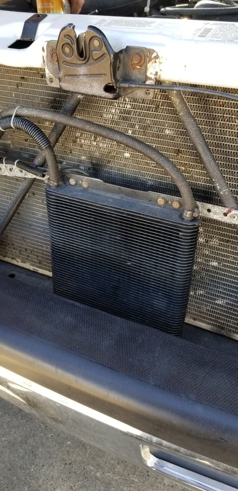

Where would I find a pre made kit? I figured my extra deep pan and the upgraded tranny cooler would be enough extra fluid lol. Where exactly is the check valve ?? I installed the cooler myself just literally removed the stock cooler and used there lines. I dunno what "hot" is considered but when I was pulling the camper and fully loaded going up the hill there was some points where it reached about 205 F then it cools down after get to level driving
I believe Monte C (in his thread) said anything below 230-240 is good. The check valve is in the bottom line. Also just search "external transmission filter kit" and you'll find them. They won't say specifically 46RE (most will say 48RE) because that is what came behind the Cummins and most Cummins owners do the external filter.
Ok good yah I haven't been close to 240 yet and even if I did I would pull over somewhere to cool off but maybe a bigger cooler down the road would help this is the tru cool one I have now
Do not quote me on that temp as I am going off of my memory, and even I can be wrong . So give it a read. I would definitely say get a bigger one
