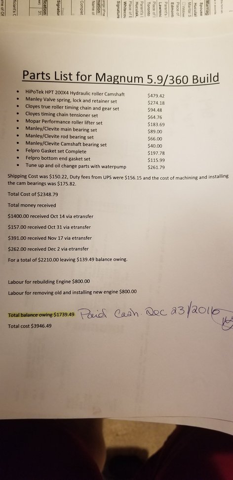

Yes it's a 360. I'm impressed you could do that with that big of tires and gears. I had 35s on here with 3.55 and the truck was a dog. So I went to 33s and 4.10s and it's better now. Truck just doesnt like climbing the hills with that little camper that's built like a tank lol. Here's motor work I had done it aswell. Straight piped with magnaflow muffler. Deep tranny pan and bigger oil cooler. You think it would get a little more punch. Maybe I should look into a tuner next and cough up some more cash
I personally believe a tuner will get you the full potential of your upgrades (especially the cam) because something is wrong. I'm not saying diesels are bad here. I just wasn't impressed. I just bought a 3/4 ton for $800 and the first thing I did was swap in a 360. For the money you were in though I would have swapped a Hemi in. You would of also had a 5spd automatic.
