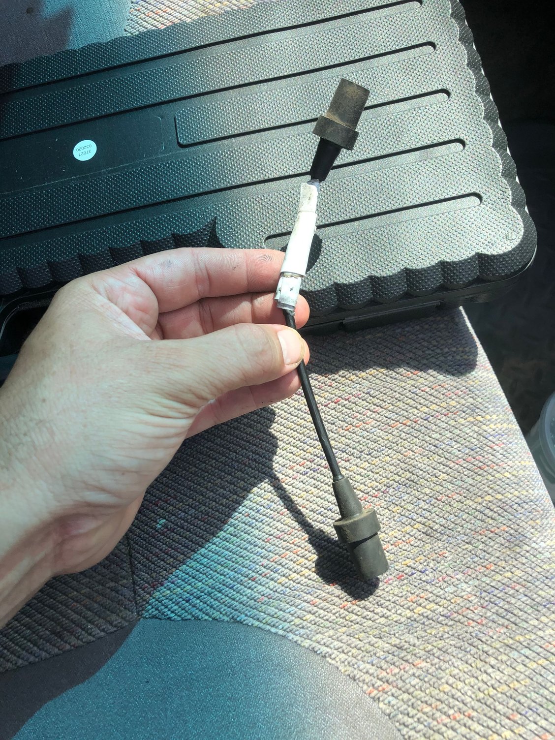

Replaced my ac compressor today all went smooth but I only had cold air blowing from the windshield vents...
checked my vacuum lines and the infamous T fitting one was broken.
i threw some electrical tape on it to diagnose and that fixed it... for an hour.
what is the name of this vacuum line? I want to buy a replacement but can’t find the correct name for it..
picture Included

I ended up cutting it short and wrapping a little tape around the end then SHOVED it into the boot. It’s half the size but so far it’s been holding up all day...
im going to check a parts yard and see if I can pull one.

The common fix is to get a hose that the little hose fits in tightly and use that.
Old Aug 9, 2020 | 08:16 PM
Posts: 87,376
Likes: 4,209
Yep, this. Use a piece of rubber vacuum line to splice the plastic line back together. It's actually a permanent fix, until the plastic breaks somewhere else.....

When I need to replace lines, I just get the rubber/viton vacuum line from the parts store. The hard plastic was a bad idea in my opinion. It is guaranteed to fail over time.
