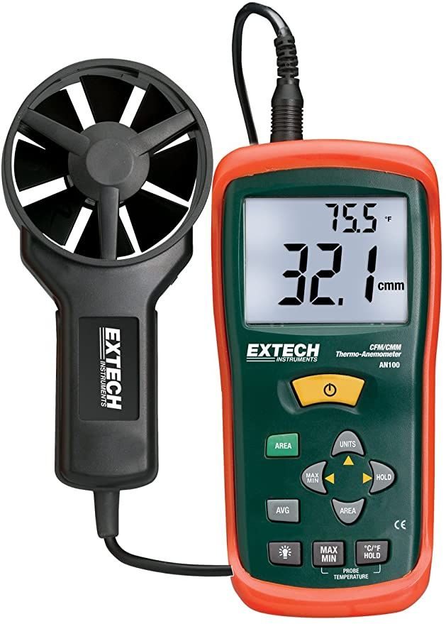

Dang that's why I hate aftermarket. I upgraded to a 3 core aluminum rad from Wizard Cooling. But they offer them on eBay. I might just have to test the factory fan. Does that store the highest number? So I could tape it to the front while driving?
