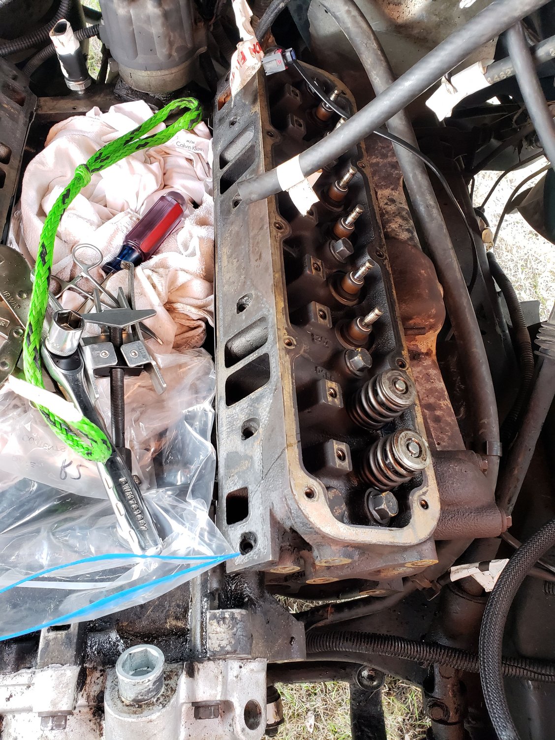

Wow these spark plug air attachments are hard to find. Probably gonna use the rope method

Old Mar 24, 2021 | 01:06 PM
Ramchie's Avatar
Ramchie
Joined: Mar 2021
Posts: 101
From: TX
This spring took about a minute to get on as compared to the hour it took with no rope. Thank you.
Should I remove that first one I put on without rope and check how the stem feels going up and down? Installed it presumably against the piston face. But I'm pretty sure I was able to crank the spring down far enough to get it on without moving the valve..
I think I'm just confusing myself with the heithese of the stem. Theres nothing I could do to fix the height, I suppose I would just be checking to make sure current spring set up is still operational and not stretched
