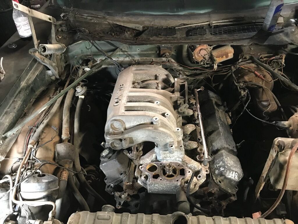

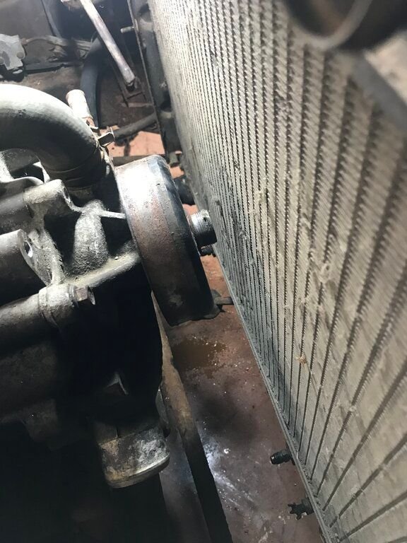

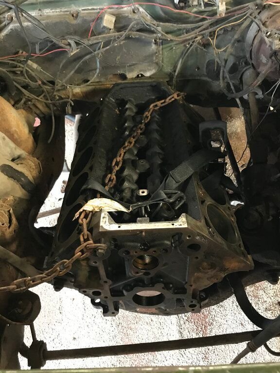

Here are some pics of the V10 in the old C body Plymouth

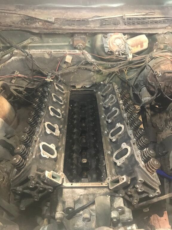

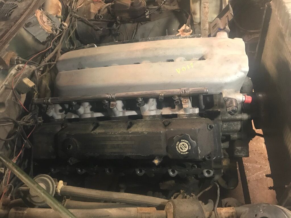

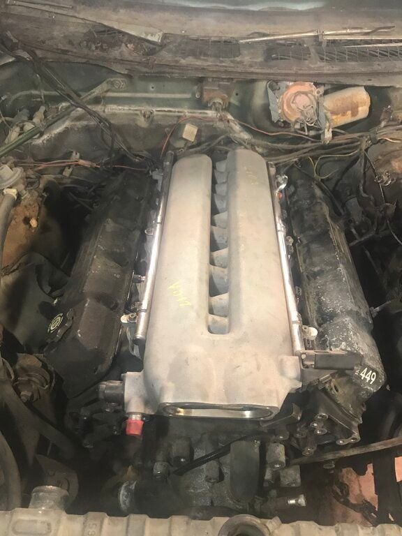

Default Viper Heads and Intake on Ram V10
Here are some pics of what it would look like with the Viper top end on the Ram block in the car. Note that I placed the truck valve covers on for looks as I don't have Viper valve covers yet. The viper valve covers are going to cost me almost as much as the GEN 1 heads cost me. LOL
Unmodified GEN 1 Viper heads on Ram Block
SRT10 Intake

I have done a bunch of research on this issue and yes the Viper vs Ram V10's are lot different but do have some similarities. The Ram V10 also has some shared components with the 5.9L Ram. The V10 also has some similarities to the B/RB blocks.
The V10 Ram block is cast iron and has a 9.68 deck height. It shares the same bore as the 5.9 and the first gen viper. It shares the same deep skirt block design as B/RB big blocks. The head bolt pattern is the same as the first gen Viper however the coolant passages are different also the deck height of the Viper block is lower.
The stroke of the V10 Ram and Viper is 3.88 the stroke of the 5.9 is 3.58 however the rod length is the same between the V10 Ram and 5.9 and the viper rods are shorter due to the lower deck height. Even though the V10 Ram and 5.9 have different stroke they use the same rods and pistons because the V10 has a higher deck height than the 5.9.
Another difference I found between the Viper and Ram V10 is the cam bearings on the Ram are stepped down and the viper are all the same size so a viper cam shaft will not work in the Ram.
What I have figured out is you can build a higher performance V10 Ram using after market rods and pistons designed for the 5.9. You can use 1st gen viper heads if you seal the stock cooling ports and drill new ones that match the Ram block. You can also use a 1st gen viper intake or SRT10 intake with the viper heads but you need a spacer plate between the intake and heads because the V10 Ram deck height is higher than the viper. Similar to using a B block intake on an RB block. You can still get better cam shafts for the Ram V10 or even have a custom one ground. This is what I plan to do when I build the new engine next winter.
These are the viper heads and I’m pointing out the coolant passages that need to be plugged then new passages drilled next to the head bolt holes to match the block.
