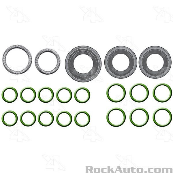

Below is a picture from four seasons showing the kit for a 2000 ram. By chance do you know which seals it used at the compressor?
I suspect it is the 2 in the upper right corner.
Old Jun 14, 2021 | 11:30 AM
Posts: 87,483
I do believe those are indeed the ones.

They are I used them when I did mine

Thanks, I ordered a kit from rockauto.

Never figured out where the bigger one went

I had really bad luck with the aftermarket o rings on my truck. I put in 2 or 3 sets of them and they all leaked. Finally broke down and bought a set of Mopar ones on ebay and they are fine. Just a heads up.
