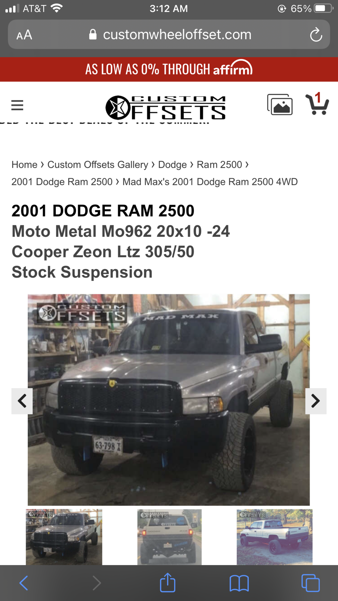

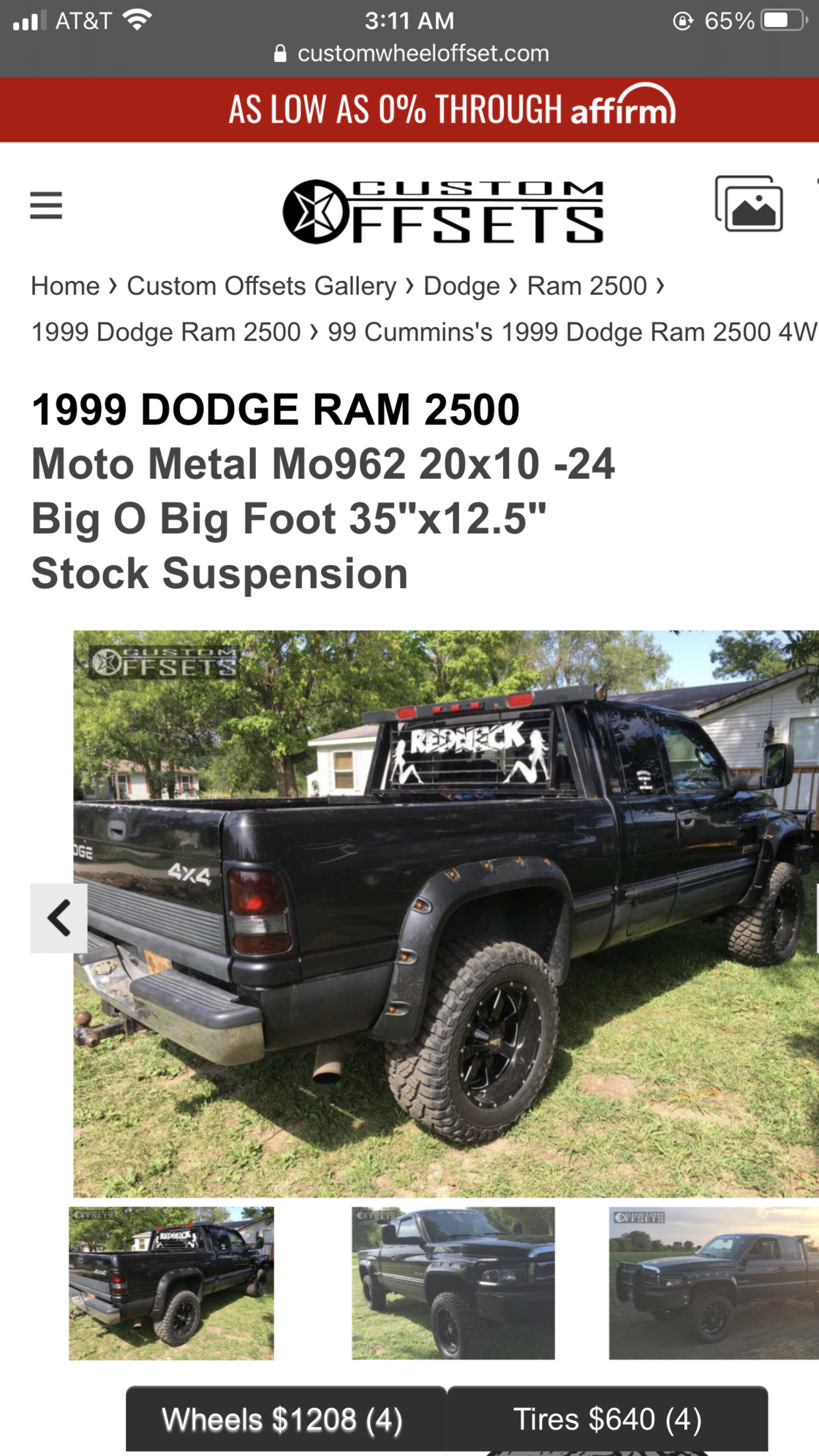

Reason is when looking on Custom Wheel Offset website there are a couple of conflicting statements with people who have 2nd Gen., same wheel type & specs, with stock suspension & no spacers.
But, they vary in what tire size & type they have.
One has a very similar type of tire at 305/50 and mentioned a slight rubber at full lock. I’m guessing it’s on the control arm since he doesn’t have flares & has a 4th Gen. bumper on 2nd Gen.
Another, claims to have 320/60 tires (that appear to be either MT or hybrid tires) states no rubbing. I would think MT’s or hybrids even at 305/50 would have a more possible chance of rubbing vs AT.

This is the one that has the similar type of tire but a slight rubbing.
This one has the more aggressive tires, but claims there’s no rubbing. Now I don’t know if it’s just because of those flares, but it looks as though the wheels don’t have as much of an offset as the ones do in the other pic.
