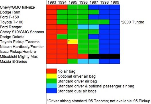

BTW, Dodge trucks first got air bags in 1994 when the second gen trucks came out. This includes the Dakotas.
I found this neat graphic that shows what year what truck came out with the airbags. Obviously, some of it was legislated.
Trending Topics
Dodge did a major redesign on the full sized trucks in 1994 so they just changed across the board to cut costs. That's also when Chrysler went with R-134 refrigerant. I bought a '93 Dakota new and they told me if it needed a/c work it would be converted.
