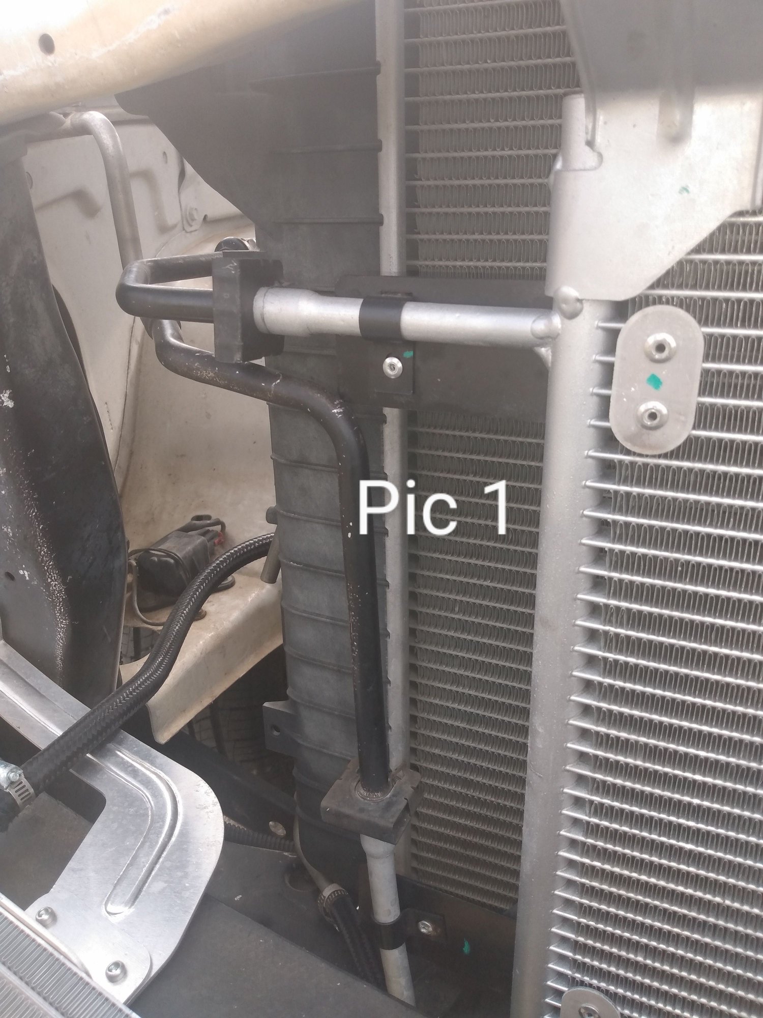

Pic 1... AT CONDENSER.. Pic 2... NOT A COUPLING, RUBBER FOR CLAMP... Pic 3... NO PINCH MARK OR DIMPLE...
Pic 4...NEW ACCUMULATOR, & IN BACKGROUND THE TUBE WITH NO PINCH MARK OR DIMPLE...Pic 5...UP FRONT GOING TO CONDENSER.....
I COULD NOT FIND ANY PINCH MARKS ANY DIMPLES ANYTHING THAT MIGHT HOLD AN ORIFICE TUBE IN PLACE. I'm wondering if the orifice is even in that too I'll just buy the whole tube but if the orifice is not in it then that's going to defeat my whole purpose. I am by far not even close back to square one but I am still kind of confused. I hope this helps.

Yeah, the orifice tube *should* be in one of the lines. The part description should mumble something about it..... I would think....

There has to be an orifice tube, or something similar somewhere, that's how a/c works. From the service manual:
The fixed orifice tube is located in the outlet line of
the condenser. It has filter screens on the inlet and
outlet ends of the tube body. The filter screens act as
a strainer for the liquid refrigerant flowing through
the fixed orifice opening. O-rings, on the tube body,
prevent the high pressure liquid refrigerant from bypassing
the orifice. Adjustments cannot be made to
the fixed orifice tube. I f i t becomes clogged or damaged,
replace the fixed orifice tube.
The fixed orifice tube assembly is the restriction
between the high and low pressure liquid refrigerant.
It meters the flow of liquid refrigerant into the evaporator
core. Minimum evaporator temperature is controlled
by sensing the pressure within the evaporator
with a pressure-operated electric cycling clutch
switch. The pressure switch controls compressor operation
as necessary to prevent evaporator freeze-up.
The fixed orifice tube should be replaced whenever
a compressor is replaced for lack of performance (internal damage)
So, it IS replaceable by itself, and is in the outlet from the condenser...... If you disconnect the line, you should be able to see it....

I suspect it is in the line that connects to the condenser outlet.

The "o" tube should be at the first connection outta the condensor. At a guess, it's possible that when you blew the lines out, you mighta forced the old one up into the tube?!? Either way, I believe that's where the "o" tube goes.
