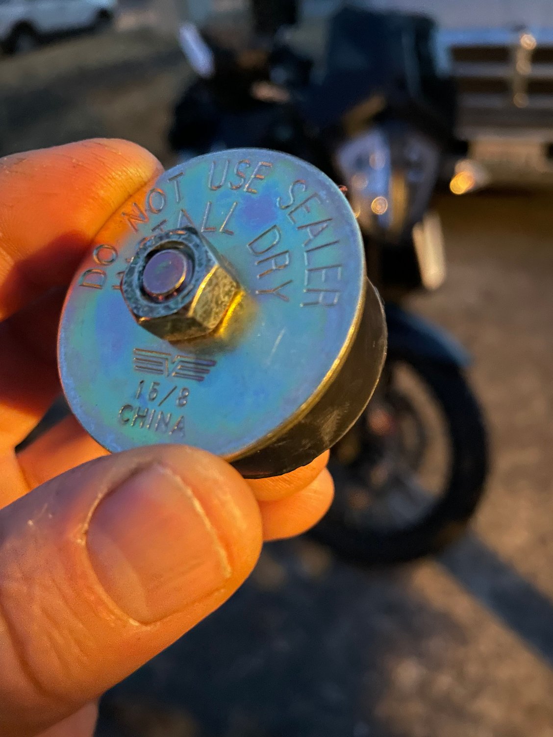

Going to use one of these for the freeze plug tomorrow morning:
If I get everything else sorted, leak down test, exhaust, etc, and the engine ends up being worthy the extra effort to put in the brass ones, I will. For now, I’m more than happy to report on how this holds up…
