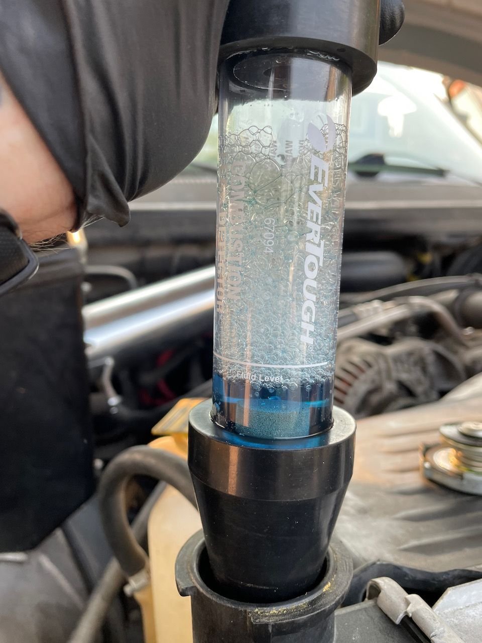

Did the block test through the radiator and the liquid stayed blue (there was the slightest greenish tint at the top of the bubbles, though). Did it 5 times to really verify that it would be worth investing anytime and money into. This photo is from about 3 minutes in, all warmed up with fan going and coolant circulating.

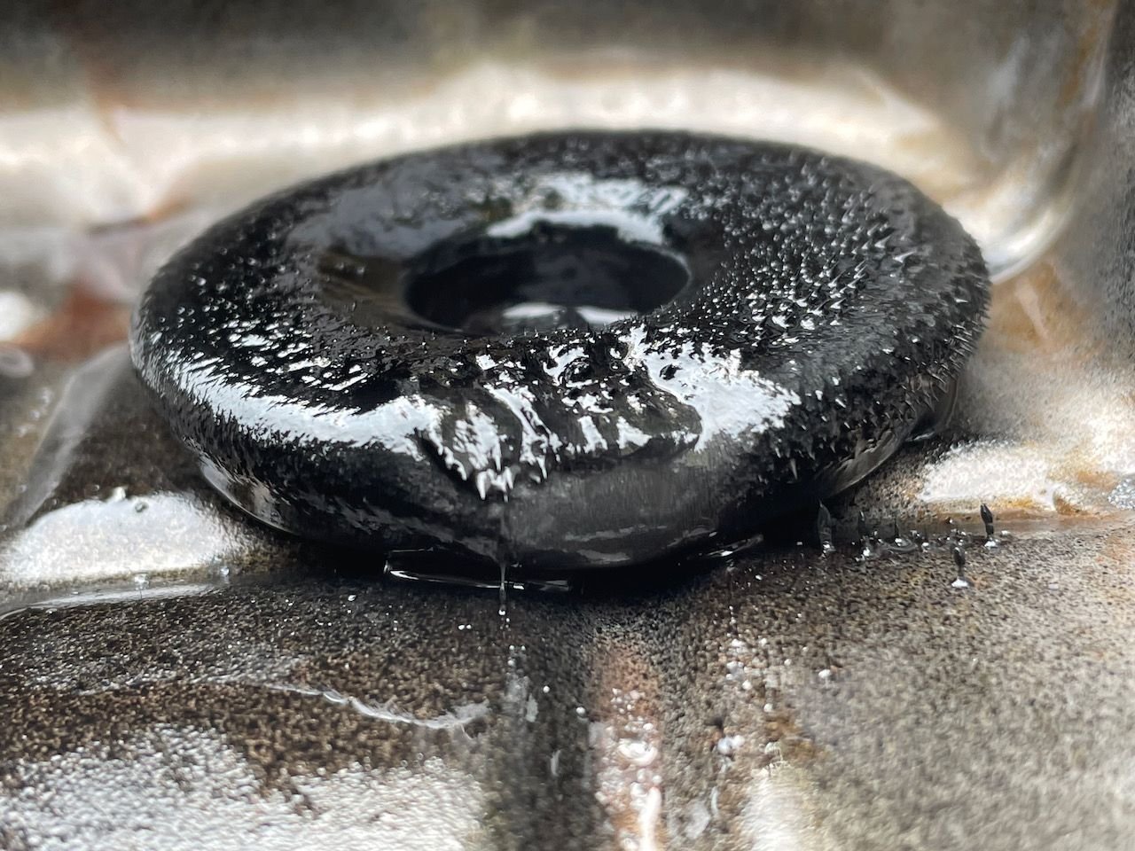

I dropped the transmission pan and changed the fluid and filter. Fluid was low. Definitely a Hostess Donette of shavings collected on the magnet, but no chunks. Helped shifting a bit. Less noise in reverse and neutral. But timing of shifts is still off.

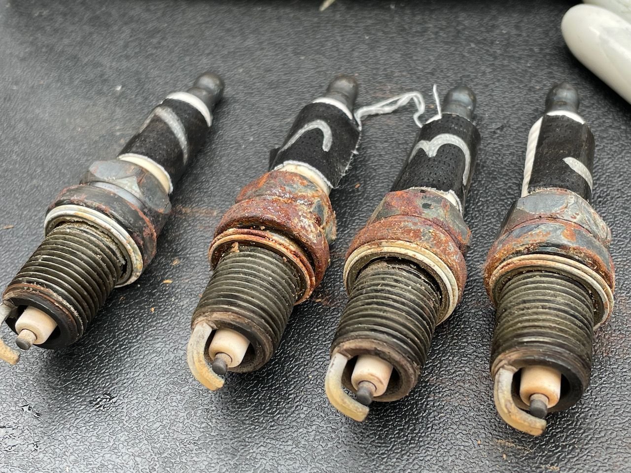

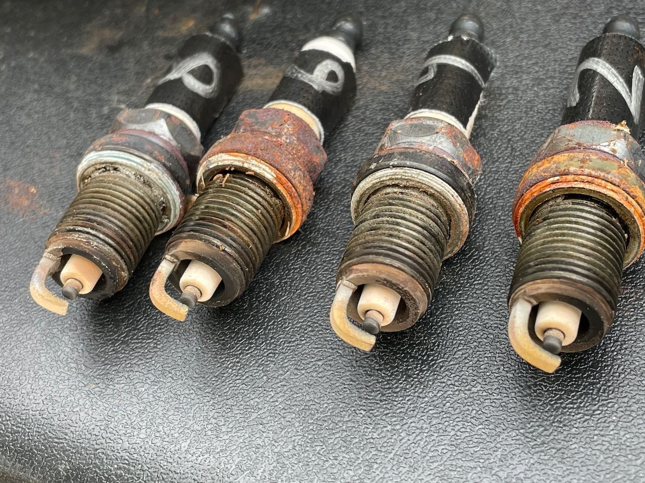

Changed spark plugs.
SP 1,3,5,7
SP 2,4,6,8

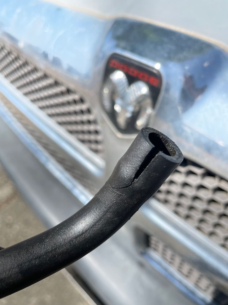

I cleaned the throttle body and replaced the IAC, MAP, and TPS, and a CRACKED HOSE from PCV to manifold all at once, so not 100% sure which helped, but it smoothed out the idle a bit. At least until it got warm… Then, while in Drive and stopped at a light, it would start dropping and surging from 650 to 600 RPM and back up, over and over. And, when in Park, it would surge from 650 to 700 RPM and back down, over and over.
cracked hose from PCV to manifold

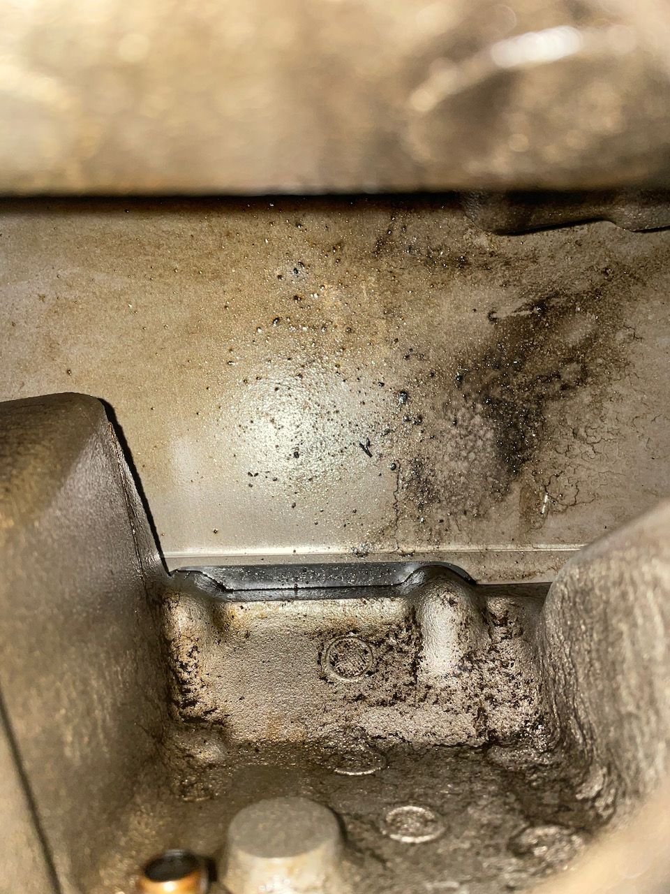

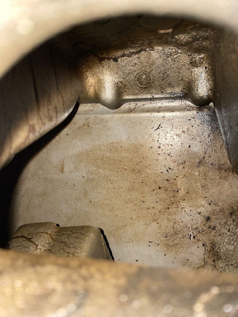

During the throttle body cleaning, I checked the plenum. A magnet stuck, so it’s definitely the original plenum. Looking inside, I see no liquid or pools of oil, but I did see what looked like dark cake/mud. I don’t loose much oil, if any.
Inside manifold looking down at plenum, left side
Inside manifold looking down at plenum, right side

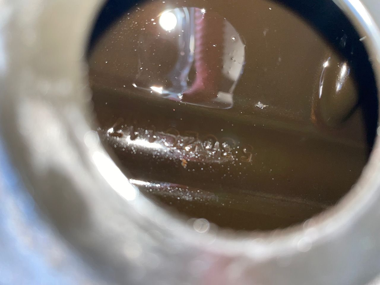

I did look inside one valve cover and saw what looked like the color of a coolant oil mix…
inside left valve cover
wider shot of left valve cover

Block combustion test passed multiple times.

Plenum looks to be OK. The stuff you see in there is likely from the PCV system. Also, get your PCV valve from the dealer, they are actually the correct flow rate. Same can't always be said for the aftermarket fellers.

But the hydrocarbon combustion test…seemed to suggest it’s not cracked.

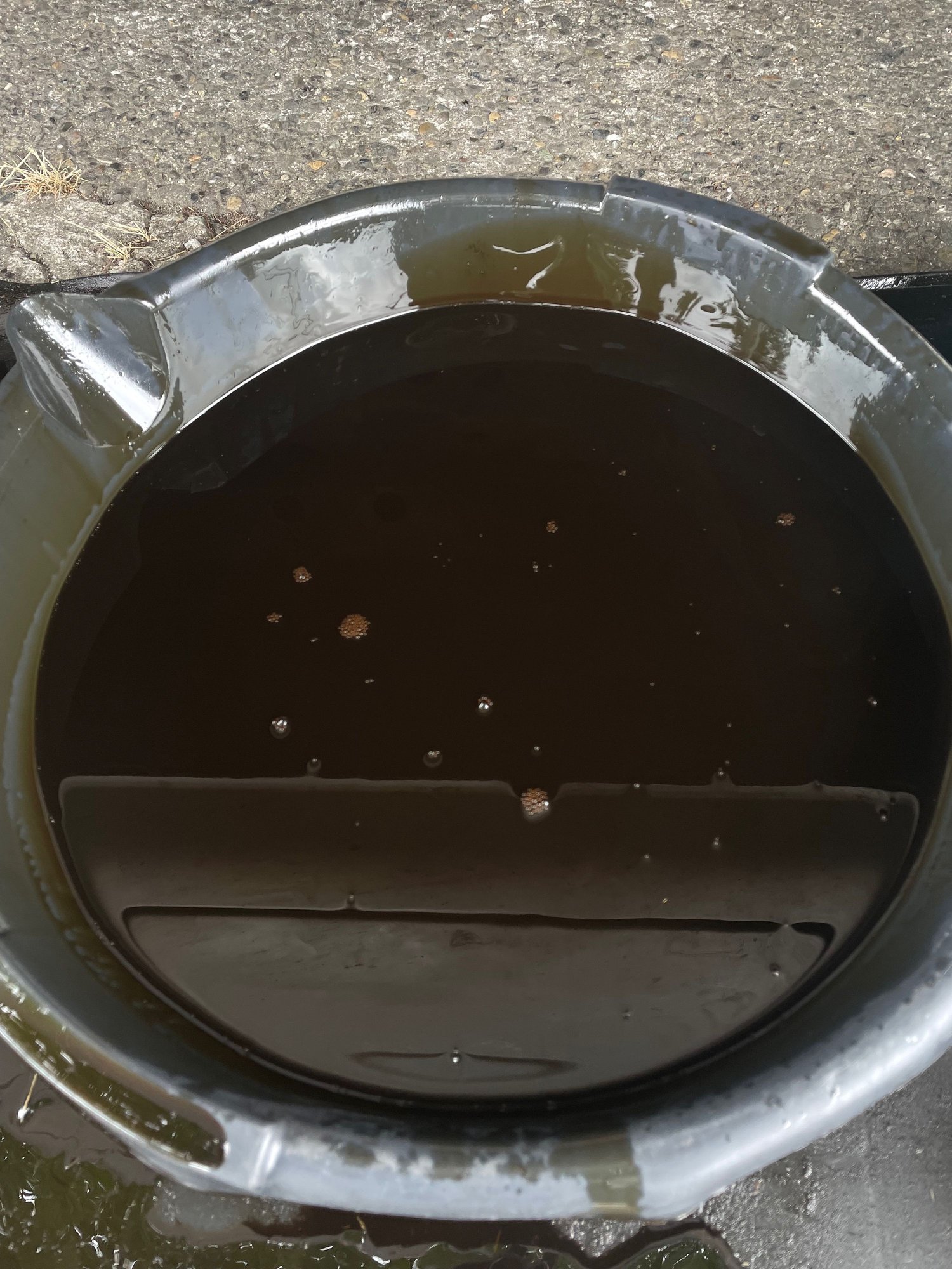

Here's my oil change today. I did run half a can of seafoam through the last 150-200 miles.

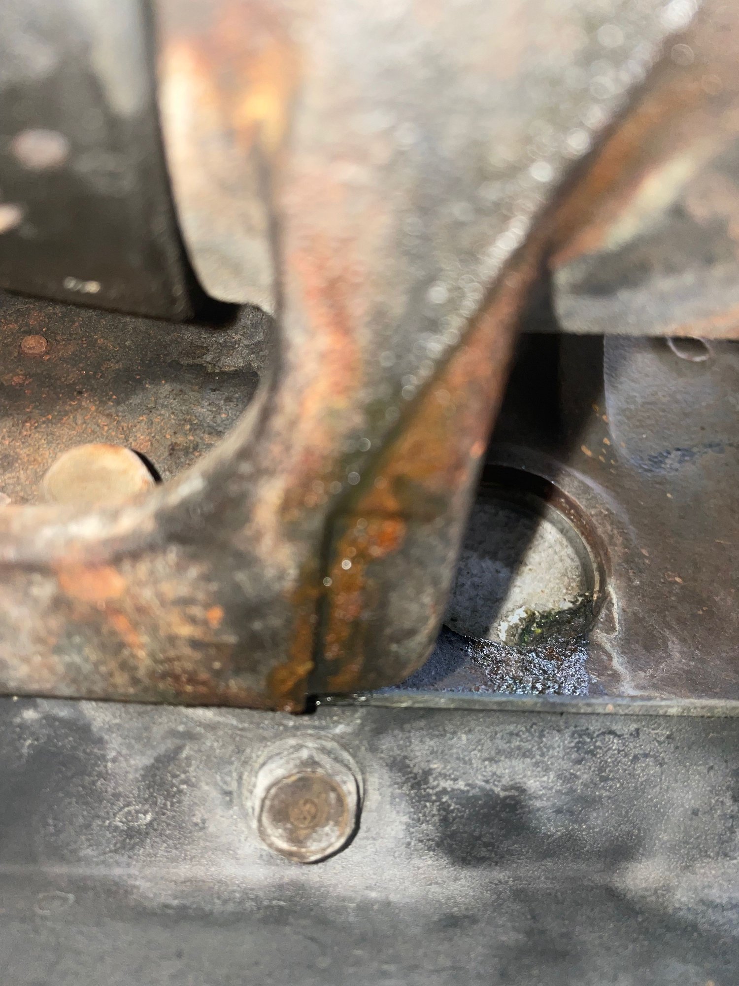

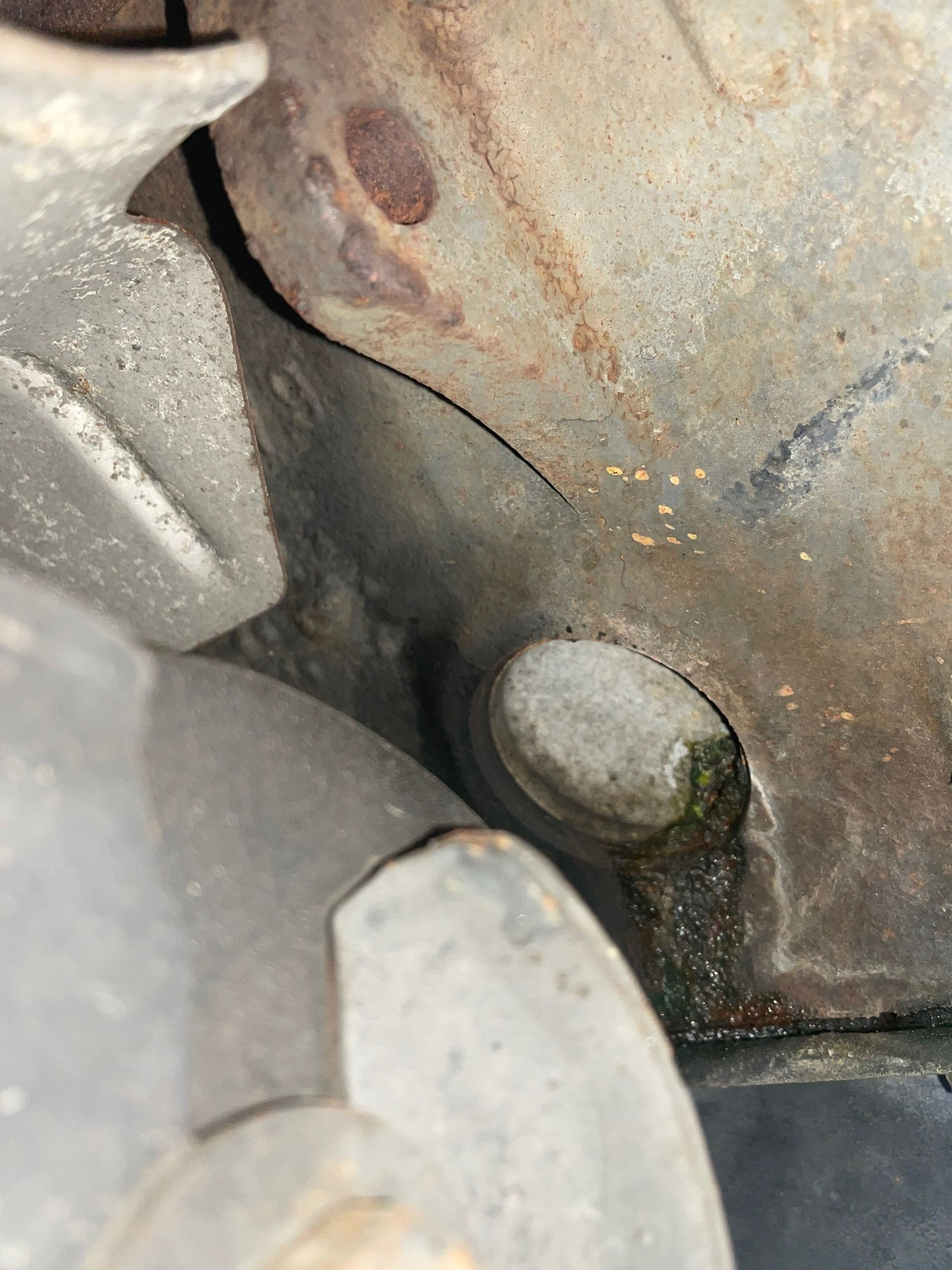

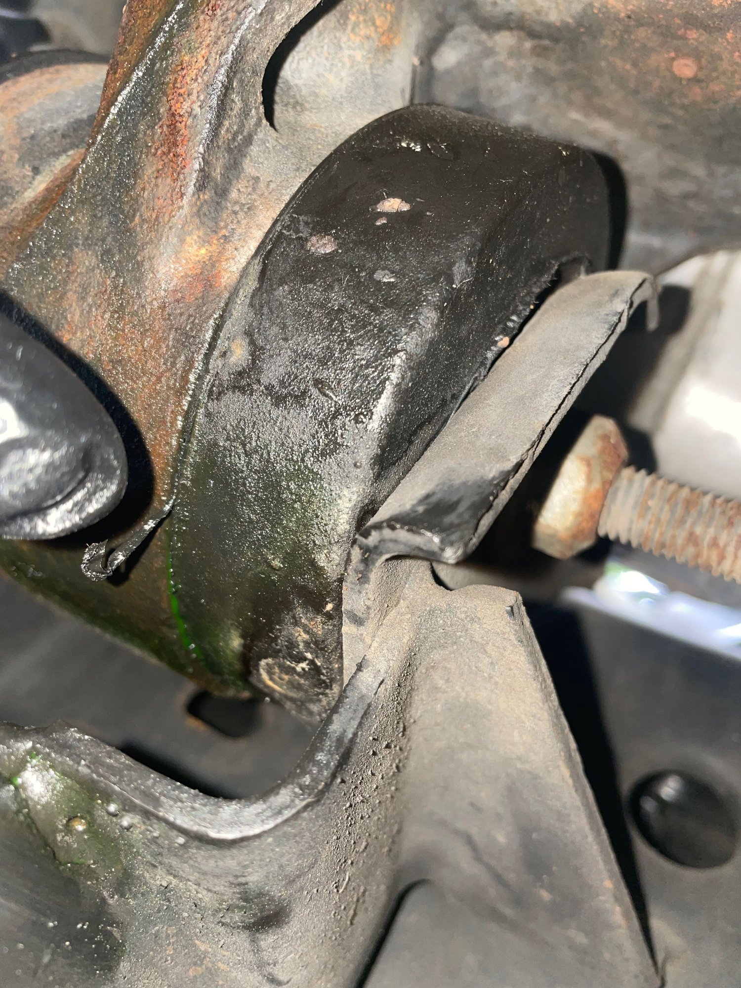

And I'm pretty sure I found the coolant leak.
Saw this while removing oil filter...
Followed it back to the front freeze plug on the block...
Ta-dah!
Checked the other freeze plugs on the side of the block and they show no corrosion.

If one of your freeze plugs is in that condition, the rest aren't too far behind.... That said, I replaced one on my truck, behind the drivers side motor mount, the rest were still fine when I sold the truck a couple years later.
