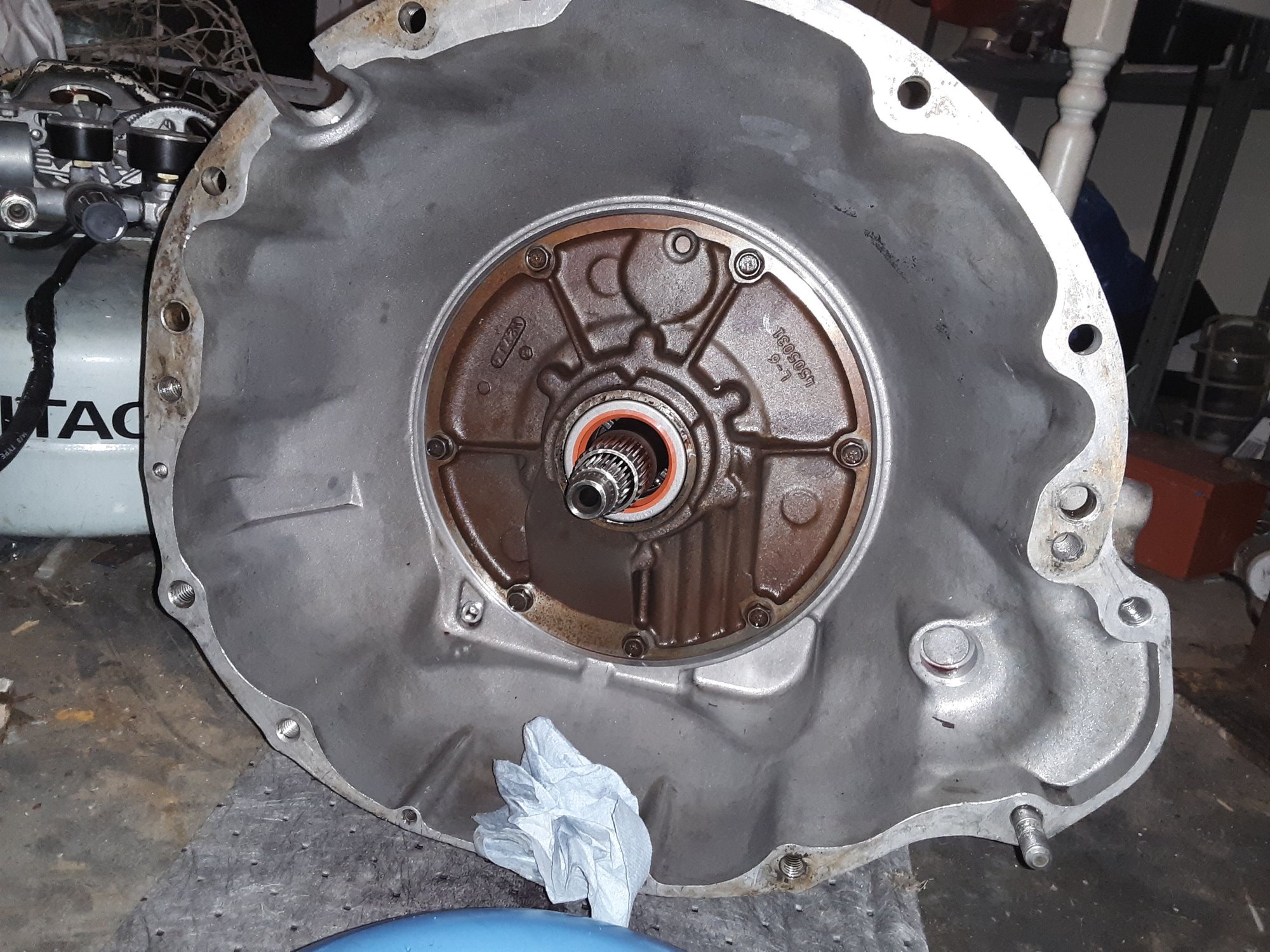

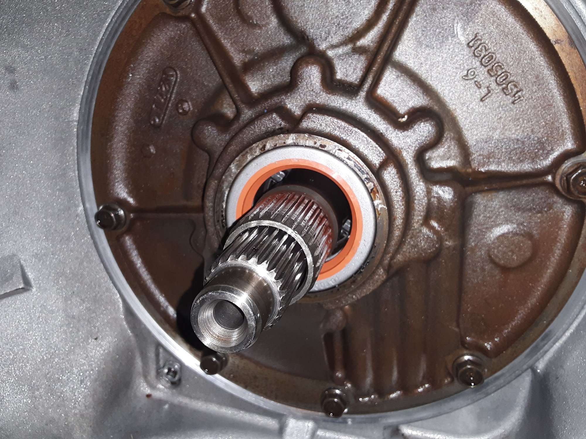

Just about the only Mopar seals i could find came in kits with pump gaskets and a bushing, so i decided to pull the pump and look at the bushing. Get a load of this.

Yes, that bushing is worn out and must be replaced. Also, check the torque converter hub's condition.

Yep, Bushing is gone. Replace both the torque converter and front pump.
