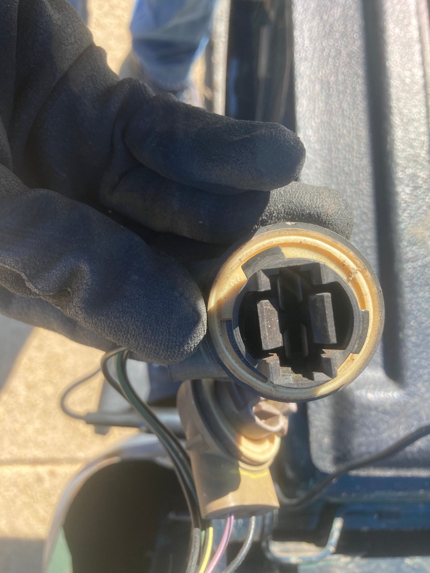

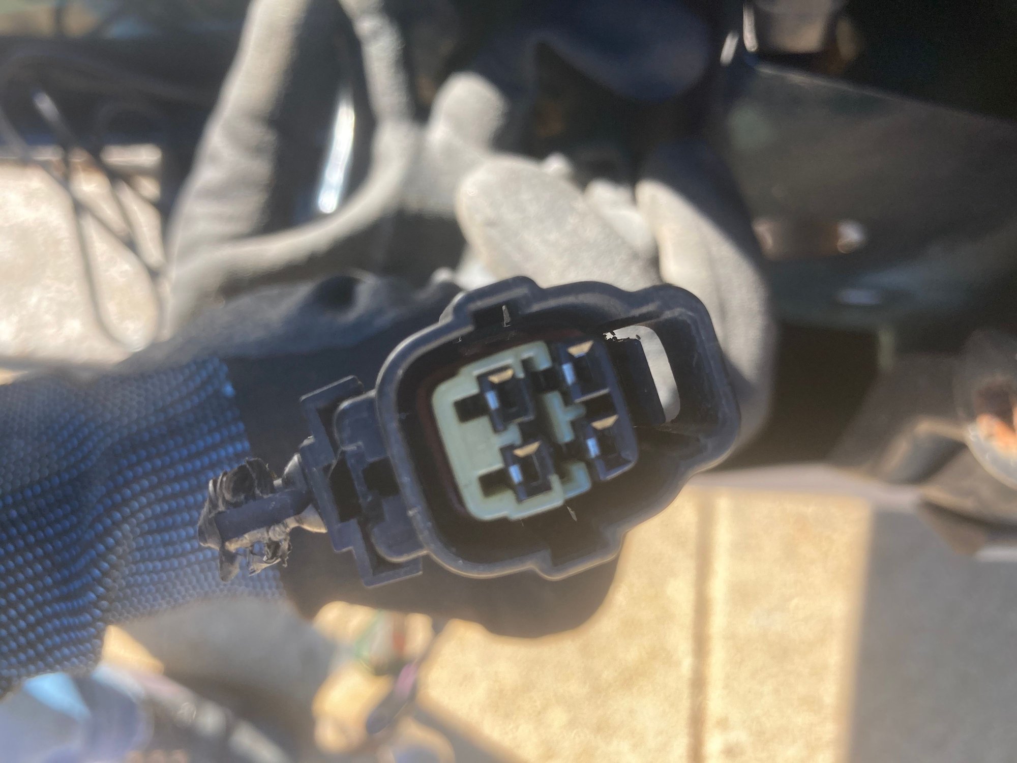

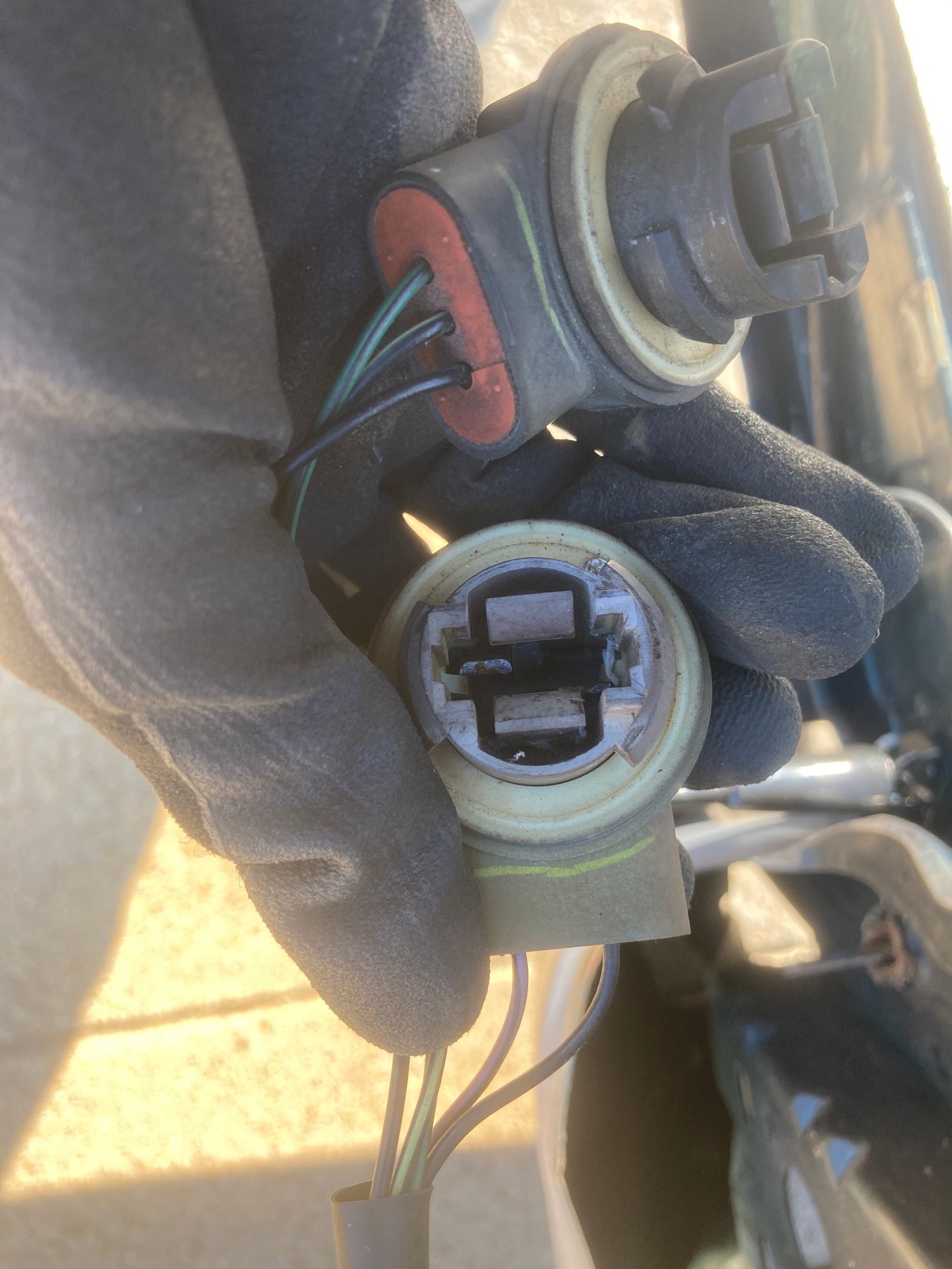

Bought the test light but I think I'm doing it wrong. Checked under the hood fuses fine but having trouble with testing the brake light wire.. I hooked up to a bolt on the side of the tailgate and tried to test the socket and connector. Nothing lit up. I see minor and major printed on the socket corresponding to wires, what does this mean ? I have posted pictures of my socket and connectors.. Do they look like they could be the issue ? Im having a hard time finding the problem with this test light and I don't want to keep driving with one tail light. Any help or suggestions is greatly appreciated

Old Jan 26, 2022 | 03:25 PM
bottom socket
top socket
Connector
that last picture is the one you want to be testing at. It will be attached to the truck.
