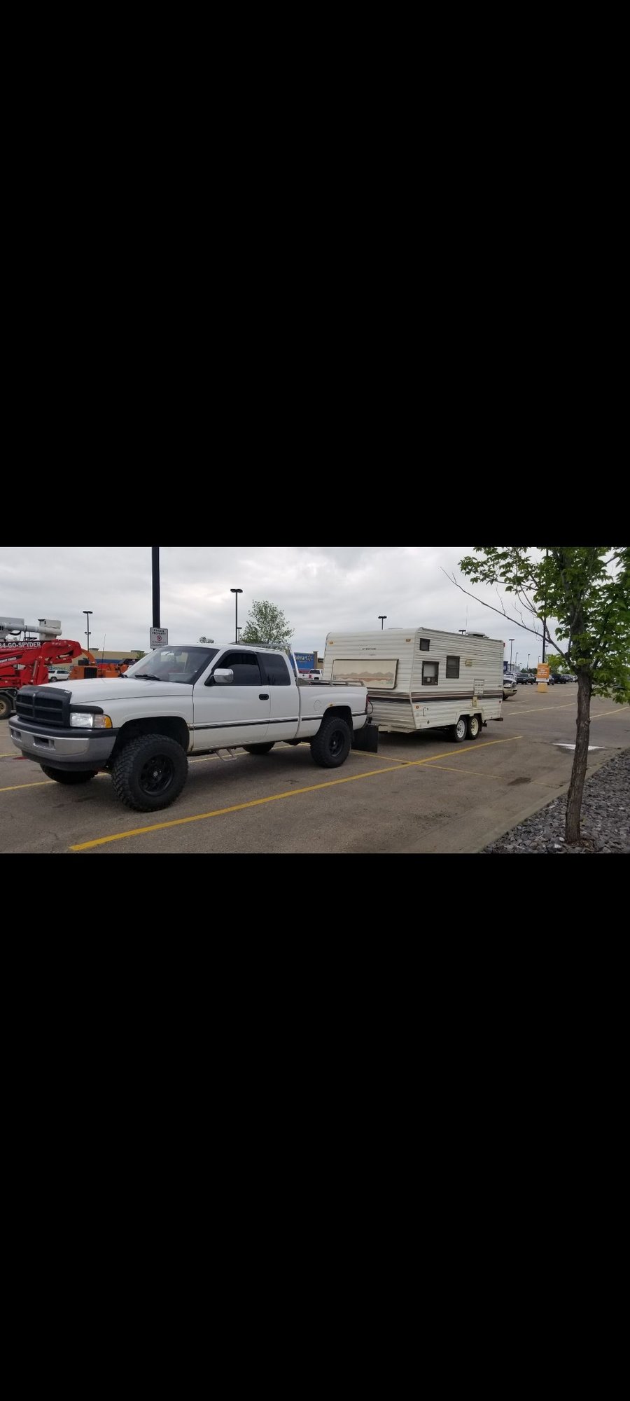

Hey guys , wondering if anyone in this group tows a 5th wheel camper with there 360? From what I understand 5th wheels " tow better" as the weight is over the axel. I currently have a older pull behind camper that weighs 3800# dry. I'm interested upgrading to a slightly bigger unit in which is a 5th wheel and sticker weight says 4800# even with the extra 1000 pounds think these older gasser can handle towing that in a 5th wheel? Only reason I'm concerned is the truck did OK at best towing the old camper I have now BUT I do have 33" tires which doesn't help anything. I do have 4.10 gears 4x4 and a recent tune which actually woke the truck up.
thanks for any advice
