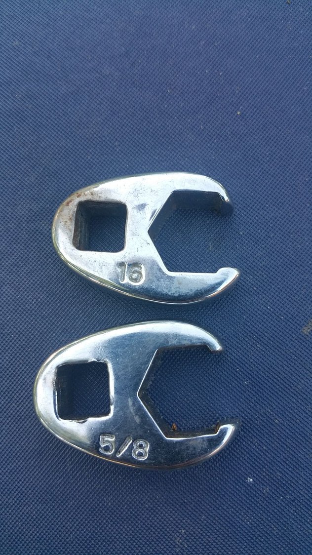

Originally Posted by chavez.braden
Any idea what size flare nut wrench I need?
On my '96 Ram 2500, these fit the flare nut for the high pressure line that screws into the back of the power steering pump. If the nut is severely rounded, some good locking pliers or Knipex water pump pliers and heat should also remove it. If the nut is rounded, I'd personally cut the metal line just behind the nut and plan on replacing the high pressure hose between the pump and the steering box.

You can find crowfoot flare nut sets cheap at Harbor Freight...
https://www.harborfreight.com/7-piec...set-93137.html
