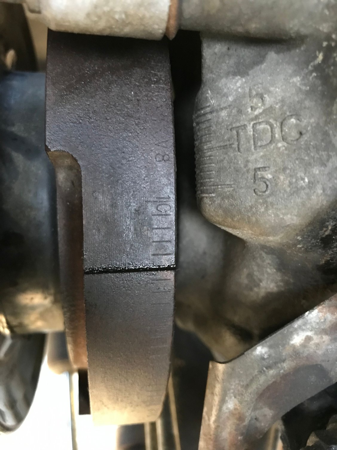

I did clean the pistons and cylinder walls. As I rotated the crankshaft while cleaning I kept and eye on the #1 cylinder on its compression stroke. I noticed that the number #1 cylinder was fully compressed when it was a mark on the harmonic balancer. It looks like that mark is zero? As it’s between two 10s?
Also when I rotated it to the v8 mark that’s when I noticed it was finished it’s compression stroke and has been decompressed a little bit.
