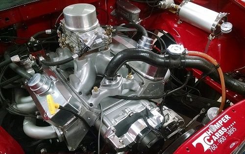

Picture of the 410 in my Race Dakota. Easy Peasy to work on.
