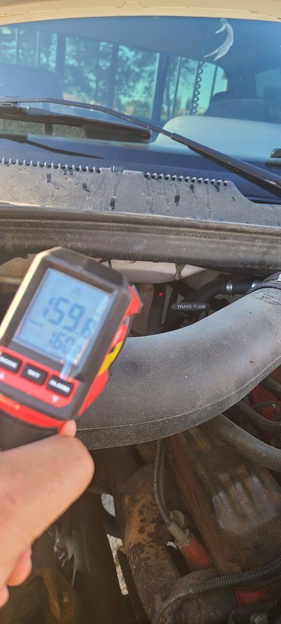

I just bought one. Do you know roughly what temp the hoses should be at?
Old Aug 8, 2022 | 07:35 PM
Posts: 87,482
Inlet should be about the same temp as your thermostat. Outlet should be colder. How much colder depends on conditions.
Old Aug 8, 2022 | 09:59 PM
96albertaram's Avatar
96albertaram
Joined: Apr 2019
Posts: 497

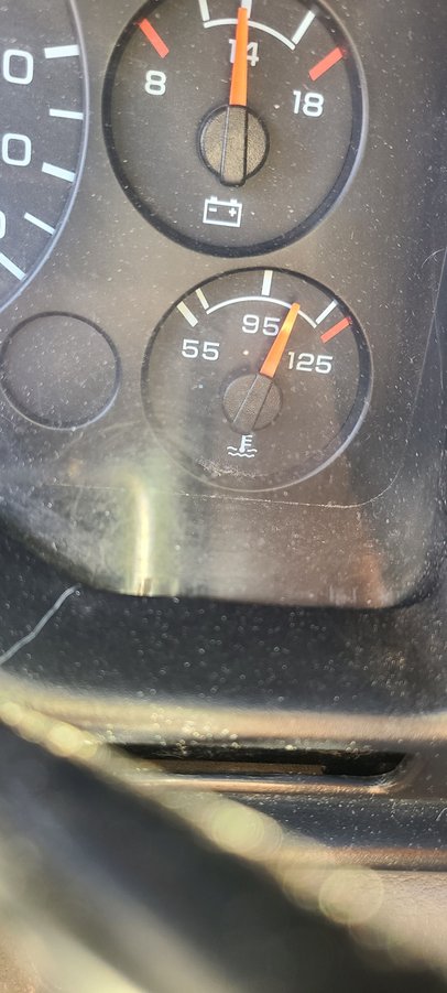

Yes sir. Left side is hotter then the right. both sides were even hotter when i got back from the car wash. Here is the Temps of the vent right now and this is where the temp gauge always sits for some reason
Old Aug 8, 2022 | 10:01 PM
96albertaram
Joined: Apr 2019
Posts: 497
Sorry I forgot to add. This haS the 195 thermostat and heat blasting on high
