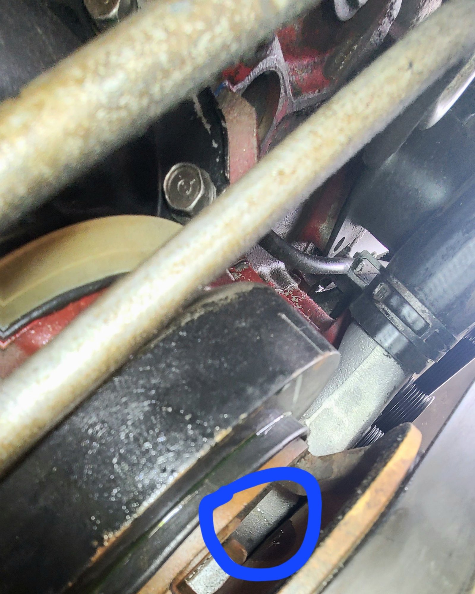

Just a update guys. I rented a rad cap pressure tool and set the pressure to 1 pound above the 16 pound rad cap rating. ( so 17 pounds ) 5 minutes later I'm getting a leak. It's coming from the bottom of the water pump and possibly above it. Does that mean this water pump is toast ? It has only 50xxx on it. Can this be part of the reason my heat isn't good ??

This is a great idea and im going to try it ! I went and rented a rad cap pressure tool and discovered im getting a leak from the water pump. Im assuming its coming from the weep hole. Does this mean the pump is toast ? And Part of the reason my heat sucks ?

I did what you suggested and rented that tool. I have a 16 pound rad cap and pressured it at 17. 5 minutes later discovered a leak and lost some pressure. It's leaking from the bottom of the water pump in thr centre. I'm assuming that's the weep hole ? Does this mean the pump is toast and its the reason why my heat sucks ?
the circle is bottom of the pump where the leak was coming from.

Might be from the weep hole in the water pump. (yep, that means pump is bad....) There is also a bypass hose cleverly concealed under the a/c compressor the might be leaking... but, I would think you would see that more down the sides of the timing cover.
