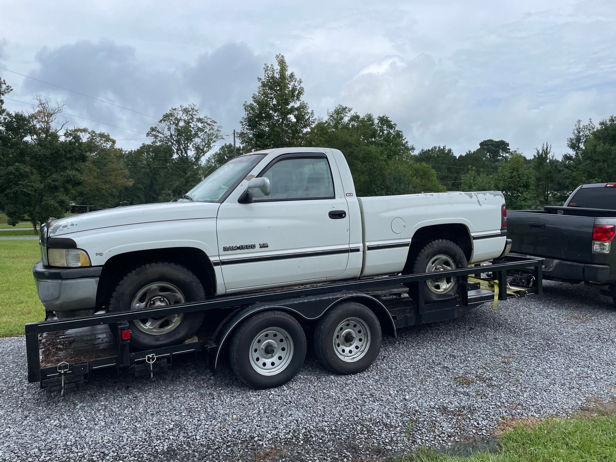

Is there a easy way to test for spark? I know on motorcycles we always just pull the plug put it in the boot and put it to the cylinder and kick it. Picking truck up tomorrow and just trying to troubleshoot it quick to get parts to throw on for the weekend.

Not getting fuel to plugs. New pump is in my truck now. Gonna drop the tank and see what happens. It tried to idle a few seconds on a little bit of starting fluid. Gonna drop the tank this afternoon hopefully
