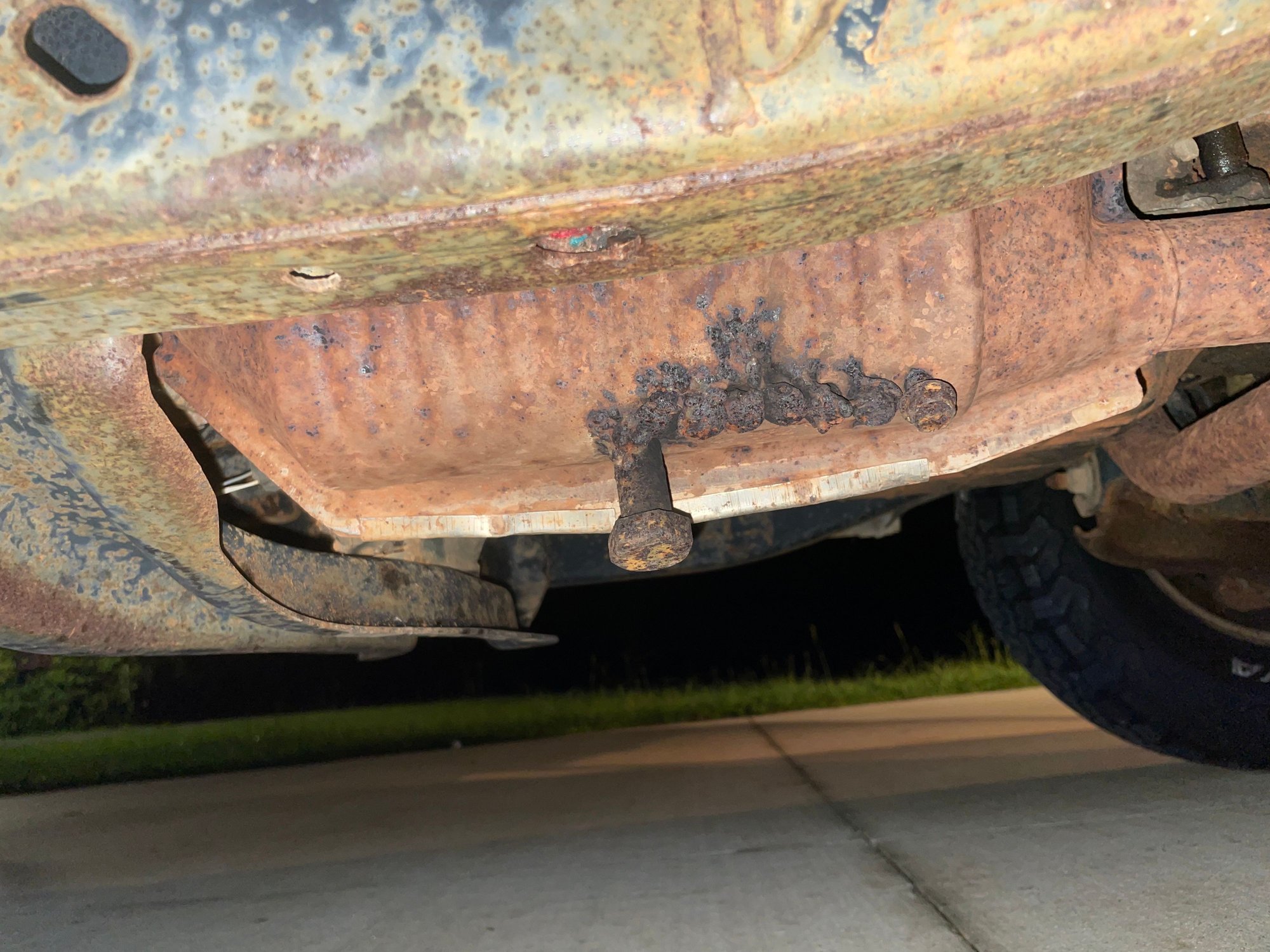

Drove it down the highway today. No issues other than a lot of squeaking and front end vibration. Pretty sure the front coils are shot. Bounces pretty good. I’m sure the ball joints and everything else on the front end needs to be replaced. Cleared the 02 sensor code. Hasn’t came back in but only ran it long enough to charge the ac system back up. I guess I need to replace the front end components, front coils and rear shocks. Last inspection sticker was 2011. Last time it was tagged was 2013. I got it around 70moh today. Is 1800-1900 rpm normal on the 318 2wd at 70? The catalytic convertor as a pretty good leak but I’m gonna get that all replaced. Would like to completely delete the cat and be done with it. Also the brake and abs light is on. My scanner says it can’t connect when I go to abs mode. May have to actually let auto zone or someone check that one for me. I also installed a set of 265/75r16 big k02’s. A local used tire shop had a good set for a really good deal. Half the price of a new set of no name tires. Not sure what he was trying to do with the catalytic convertor but I had to post a pic of it.
