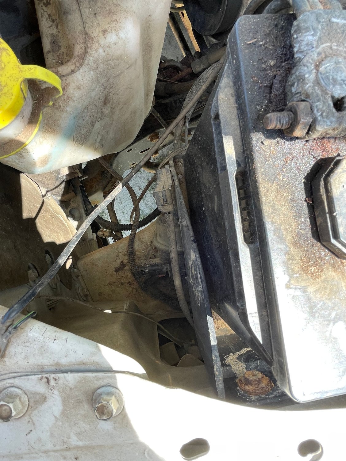

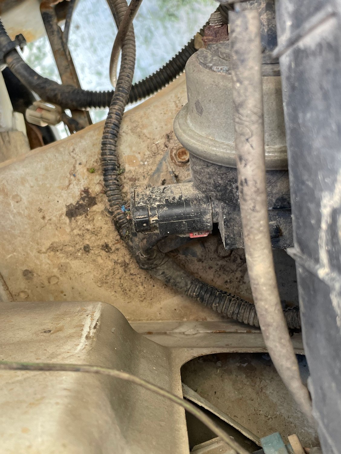

I noticed the ac compressor sounds like it kicks on and off randomly. Figure it’s the low psi switch. But when I accelerate a little more than normally it quits blowing. I’ve read the tread on it. Also the cruise doesn’t work. The light blinks occasionally when trying it. Assuming I gotta find a vacuum leak somewhere from what I can gather from the threads. Looks like a common one is under the battery. I popped the hood and just took a quick look earlier and noticed this electrical connection that looks like it’s been cut off…? Does anyone happen to know what this was for? It’s on the front of the battery box area towards the headlight.
