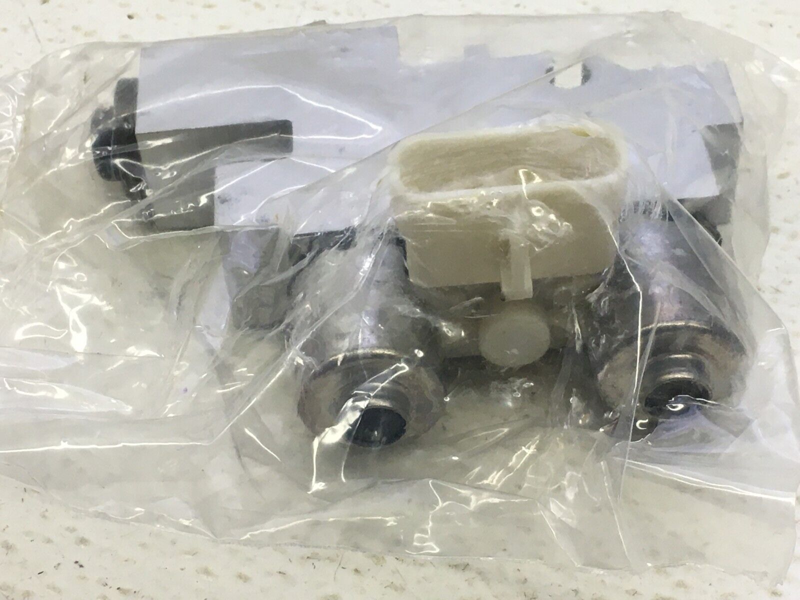

It seems to be throwing codes then not. Meaning I got another code today about rear senor which I replaced a few months ago when my speedo wasn't working. I am going to pull the plug and check and clean it just in case. I took some picture of the valves I been speaking of but it's not a suitable file. I have found one on eBay that is OE and supposed to be new for $170.00. I will post a picture of it. My thinking is the valve is shorting out which is why I am getting those codes? As for the rear. That just came up today. I was thinking about taking this one out and seeing if there is way to maybe clear it since my thinking is the two on top seem to be a relay. What do you think?

That valve is readily available locally at pick and pay salvage yards on a variety of vehicles - Durango, Ram, Dakota, etc. I picked up a couple of used valves and plan to replace the one on my truck one of these days since the two metal solenoid covers appear to be rusting out. Might want to check your wiring closely to ensure nothing there is bare/shorting. I'm thinking that those valves are pretty tough, as we haven't heard about them failing, unlike Takarta airbags...
