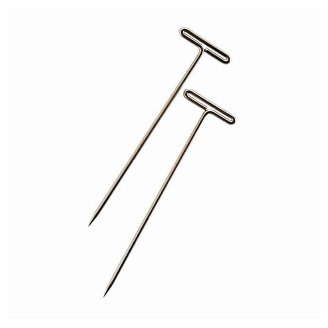

Here is a way to check hall effect sensors(cam/crank). You will need a T pin to probe the connector.
