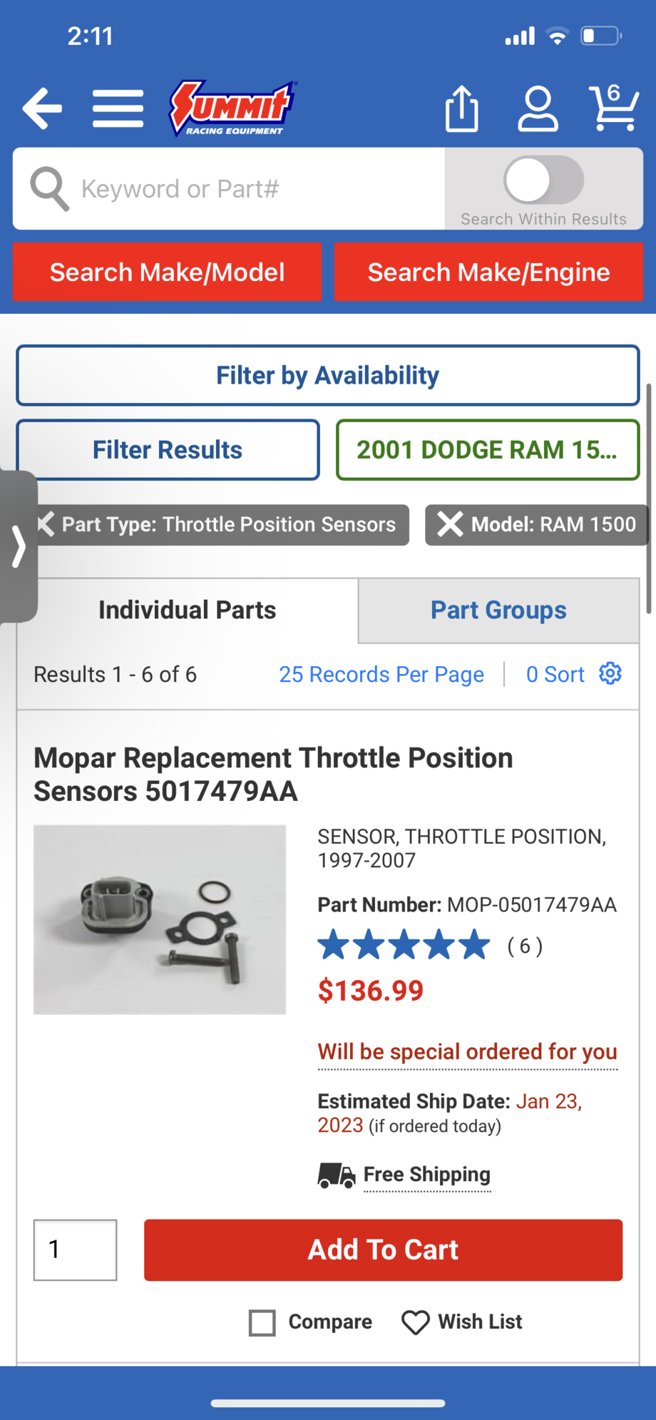

You want to use OE sensors, and yes, they are more expensive, but, that's because they actually work right..... Using the cheap china sensors tends to introduce 'mystery' problems, that are hard to trace. This is especially true on critical sensors, like crank, and cam position. ONLY OEM on those.....
So that’s a no for these?
more like this?

Definitely a 'no' on the aftermarket IAC and TPS. Use the part number and shop around (Google, eBay, etc.) for the Mopar TPS. Might find it at better pricing..
