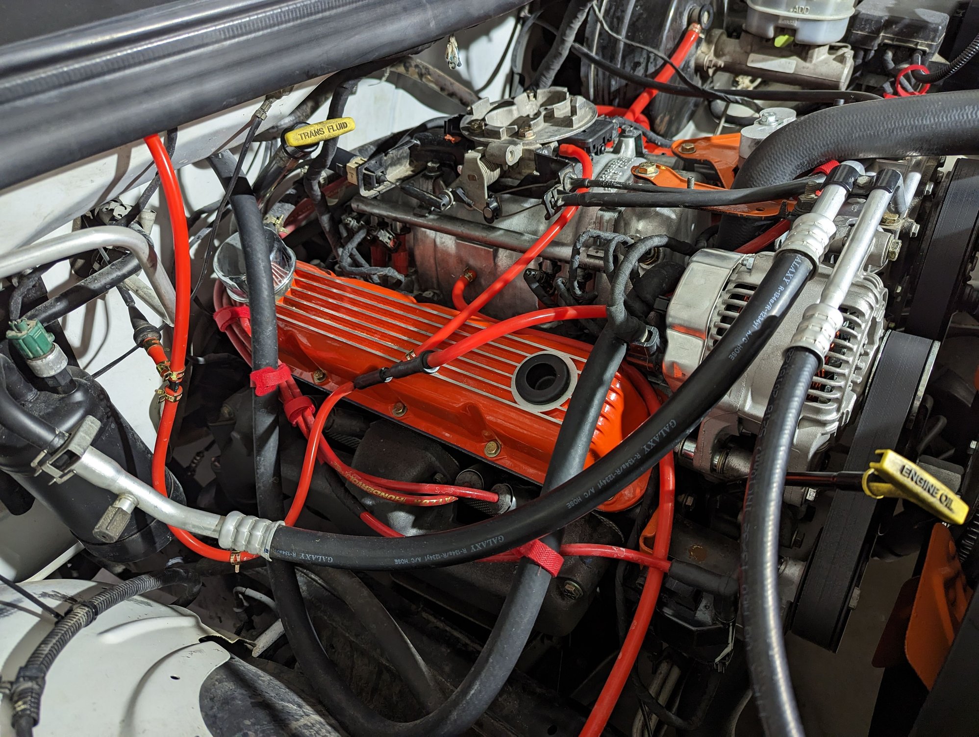

So I've been working on restoring my 2000 1500 with the 5.9l magnum for the better part of this last year, and finally have everything installed and good to go, or so I thought. I can get the engine to turn over and idle, but the second I try to give it any throttle it chokes and dies. I took off the air cleaner and sprayed some starter fluid into the throttle body to see what it did and it had a similar result, so I'm thinking I have some issue with the air/fuel mixture. I also checked for a vacuum leak around the intake manifold with the starter fluid and it didn't appear to be the issue. I've double checked the gaskets on the throttle body and sensors, replaced one I thought looked a bit worn on the TPS, but otherwise I have no idea where there could be an issue besides the plenum. I bought the Hughes engines plenum upgrade kit and installed it per the instructions, and while I was inspecting the throttle body I looked into the intake manifold and the plenum looked clean so I don't think there's a leak. I thought it might be possible I have some dead o2 sensors, so I replaced all four of them to no avail.
Practically everything in the engine compartment except for the brake booster and master cylinder is brand new.
Anyone have any ideas as to what I can do?
