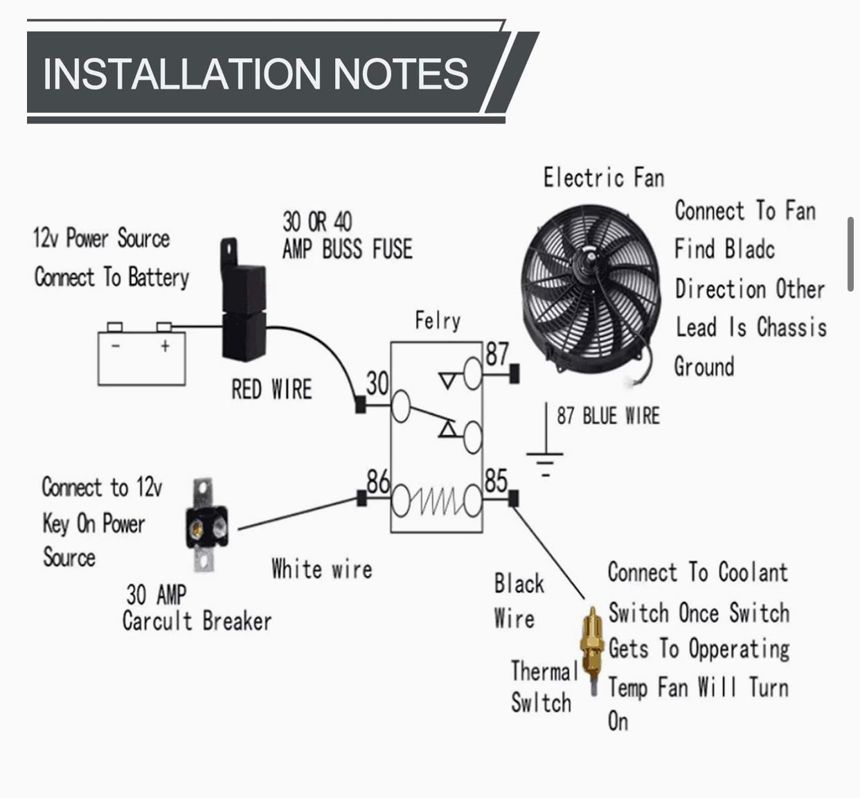

1 more thing, picking up a 2nd 16in fan would actually be super useful. I already bought the fan controllee for 1 fan. To save some money and not having to purchase a completely new wiring kit. What do I add to make another 16in fan work?
also, what about my alternator? It’s stock specs. Not original alternator but is pretty old and the alternator Diode I think it’s called, whatever wire goes to the battery negative and to the back of alternator. It’s split at the end and has corroded copper showing.
This is what the 1 16in fan installation suggest. What about for 2? Thank you for helping me !
yes, you would want pin 30 on each relay having its own power supply and fuse
pin 86 could be shared between relays, as well as pin 85. Id like to see what relays they are using having it fused at 30amp, i think a 2.5amp would be plenty at most a 5amp
I didnt see the specs on the fans, being fused at 30 I wouldnt expect them to be using much over 15amps apiece, probably more like 10, your alternator should be fine, but if it ever goes out an upgrade wouldnt be the worst decision, especialy if you a big audio head also
i will actually be getting into audio soon.
It’s 10 amp each fan. 120W 12V
I think the relays are 40A
