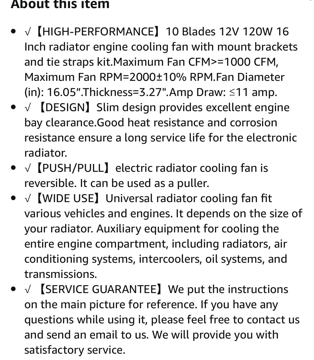

is there a rating for the fans for startup draw?? That's generally pretty steep.
sadly this is all Amazon gives me for this fan.
