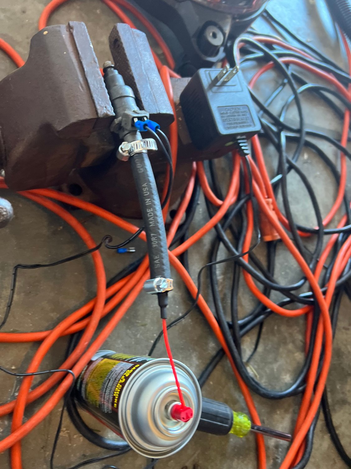

Here is how I cleaned mine. I took a 12 volt aC adapter and plugged it into a power strip with a on/off switch. I crimped spade connectors onto the end of each wire. I had to squish the spade connectors to make them more narrow.
now I could put each wire on a connector for the injector. After that all I had to do was engage the rocker switch to on the power strip to open the injector solenoid.
Then I took a can of carb cleaner and I put a vacuum hose splice on the end of the red tube with adhesive. Then I put a piece of tubing on the outside of the vacuum splice. I think I used adhesive heat shrink to make it stay together under pressure.
At this point I put the tubing on the outlet of each injector. I pushed the switch and sprayed injector cleaner through each injector… Backwards to clean the screens by back flushing. Afterwards I turned them around and did them all forwards, and made sure I got a good spray pattern out of the injectors.

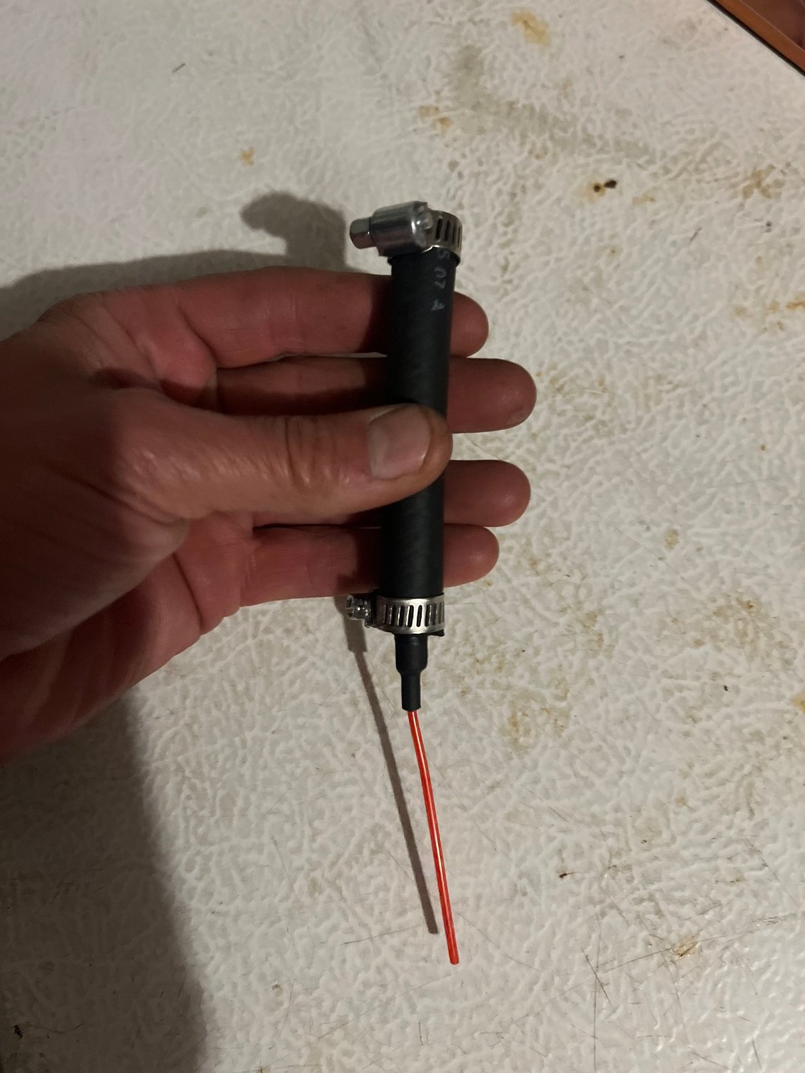

Going to make a few runs to get carb cleaner and hose to make a cleaning tool as pictured. It threw a PO420 code so after researching, my guess would be most likely one or more of my injectors /misfire has brought this code on since I just replaced both O2 sensors after I did the transmission. It be all over the place with the misfire issue. sometimes barely can feel them to lightly rough idle then back again to light misfire. Most likely Sunday morning will be when I pull them. Will update.
